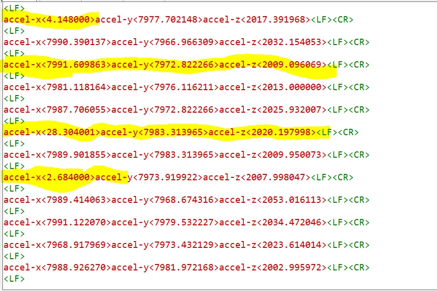

I am trying to using LDM6DSL just for it's linear acceleration sensor to detect movement. The values i receive from the sensor are fluctuating a lot even when the sensor is in a steady position?
I have only used the CTRL6_C(15h) and CTRL1_XL(10h) register to configure the linear acceleration sensor and I am reader the value from register 28h to 2Dh.
void i2c_write(uint8_t imudevaddr, uint8_t* write_2_reg_addr_data,int No_of_bytes)
HAL_I2C_Master_Transmit(&hi2c2,imudevaddr,write_2_reg_addr_data,No_of_bytes,100);
HAL_Delay(10);
float i2c_read(uint8_t imudevaddr,uint8_t regaddr)
uint8_t accelerometer[2];
float Acc;
unsigned int raw;
HAL_I2C_Master_Transmit(&hi2c2,imudevaddr,&regaddr,1,10);
HAL_I2C_Master_Receive(&hi2c2,imudevaddr,&accelerometer[0],2,10);
raw = (accelerometer[1]<<8|accelerometer[0]);
Acc=(((float)raw)*0.122f);
return Acc;
void imu_accelerometer_read(uint8_t imudevaddr)
//uint8_t imudevaddr=0xD4; imu address
uint8_t LASCR[2]; //LASCR linear acceleration sensor control register 1 (CTRL1_XL(0x10) in docs)
LASCR[0]=0x10;
LASCR[1]=0x90;
i2c_write(imudevaddr,LASCR,2);
LASCR[0]=0x15;
LASCR[1]=0x00;
float x=0.0,y=0.0,z=0.0;
imudevaddr = imudevaddr+0x01;
x=i2c_read(imudevaddr,0x28);
y=i2c_read(imudevaddr,0x2A);
z=i2c_read(imudevaddr,0x2C);
sprintf(i2c2_buffer,"accel-x<%f>accel-y<%f>accel-z<%f>",x,y,z);
uprintf(i2c2_buffer);
uprintf("\r\n");
HAL_Delay(500);

    > unsigned int raw;
    Aren't the sensor values signed ?
    Where is this factor coming from ? Your screenshot shows no units.
    In other words, get the raw return values, and check their plausibility.
