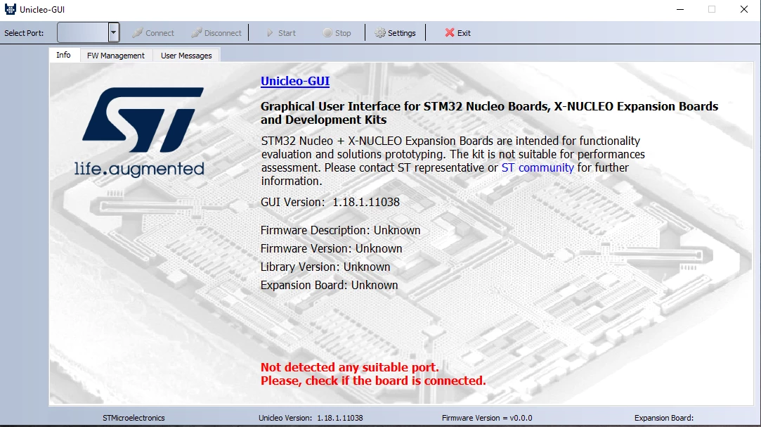

I am trying to connect my sensortile.box with Unicleo-GUI, but it shows an error saying that the port is not detected. I am using windows 10 kindly help me in this Regards

    Hi @Usman​ ,
    Did you download the DataLogExtended example on the SensorTile.box? Its main function is to show how to use SensorTile.box to send data using USB to a connected PC or Desktop and display it on specific application Unicleo-GUI V1.11.0.
    You can find the .bin file in the FP-SNS-STBOX1, folder \Projects\STM32L4R9ZI-SensorTile.box\Applications\DataLogExtended\Binary.
    Let me please know if this is related to the issue.
    -Eleon

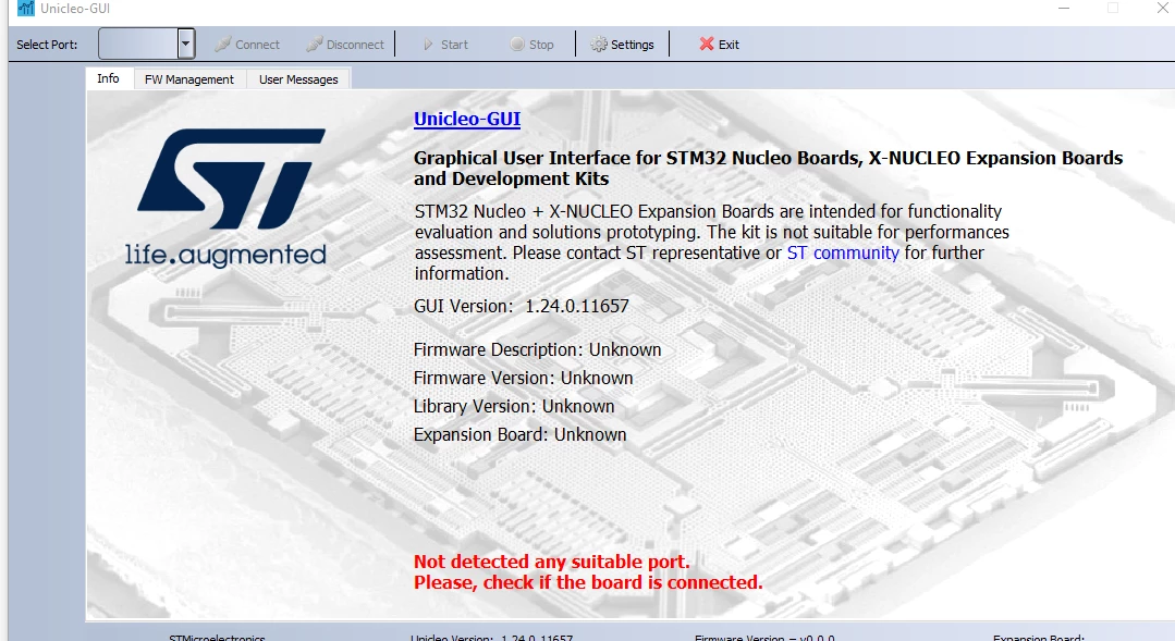

    Hi @Eleon BORLINI​ ,
    My unicleo gui said also the same. I have browse that binary file through STM32CubeProgrammer(firmware) and also had download this already FP-SNS-STBOX1, . Can You tell what is the issue, then?
