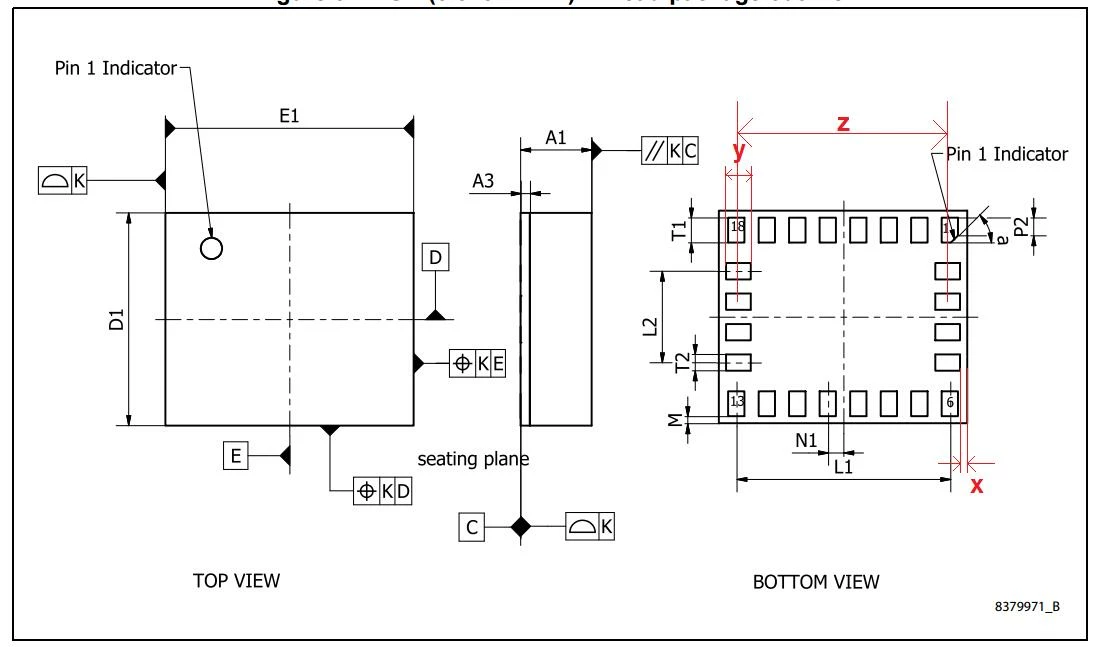

I am not able to get exact information for footprint creation of LSM9DS1, can anyone help pls

x = ?
y= ?
z = ?
    Best answer by Miroslav BATEK
    Posted on January 25, 2017 at 10:49
    All the pads are the same.
    x = M = typ. 0.1 mm
    y = T1 = typ. 0.35mm
    z = E1 - T1 - 2xM = typ. 2.95mm

    Chithambara Ganesh
    January 25, 2017
    Posted on January 25, 2017 at 11:49
    Thanks Miroslav for your reply,
    from your reply i am understanding in following way, Please correct me if i am wrong,
    1) x = distance between component right edge and right edge of pin5
    it is same as 'distance between component bottom edge &  bottom edge of pin 13' which is M=0.1mm
    2) y = Pad width of pin 17
    All pads from 1-18 are of same size
    So y=T1=0.35mm
    3) z= distance between center of Pins  2 and 17
    z=E1-T1(pad width of pin 17)-2xM
    so Z=2.95mm
    Please conform ASAP.
    January 25, 2017
    Posted on January 25, 2017 at 12:08
    Yes, your understanding is correct.
