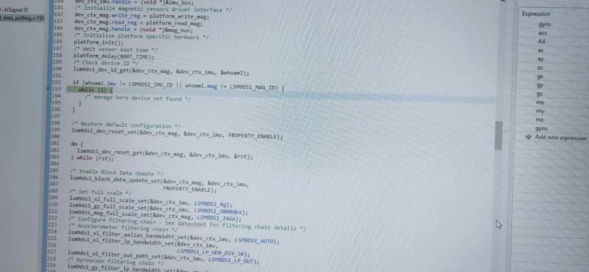

I am interfacing this lsm9ds1 MEMS sensor with the STM32F429zit6 nucleo board. LSM9DS1 IS NOT Responding I am using ST lsm9ds1 drivers on github using data polling code sensor is not responding, anyone tell me where the problem occures?

it returns always 0x00 only

continuesly looping never get out of the loop.

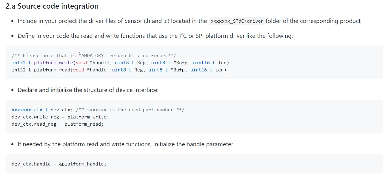

how can i configure platform write and read in application code whre we are included that functions.

im not mention platform write and read in main.c is this mention or not?
PRAMU.11
PRAMU.11Author
July 2, 2021
/** Please note that is MANDATORY: return 0 -> no Error.**/
int32_t platform_write(void *handle, uint8_t Reg, uint8_t *Bufp, uint16_t len)
int32_t platform_read(void *handle, uint8_t Reg, uint8_t *Bufp, uint16_t len)
where can i write these functions

In order to integrate the, you can refer to the dedicated section in the readme file of Github homepage, at the paragraph:
0693W00000Bd5pGQAR.pngDid you already try this procedure?
