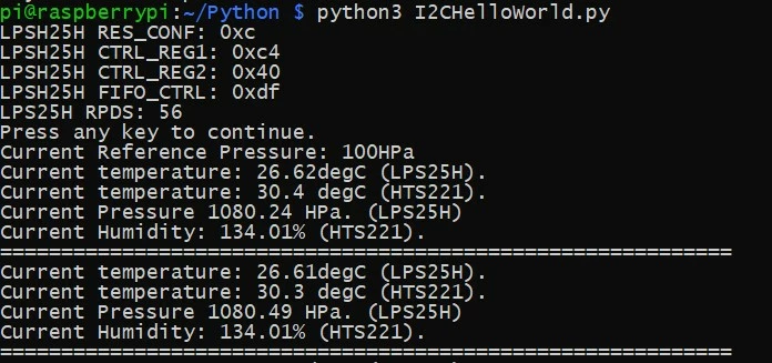

I am getting erroneous readings for Pressure(hPa) and Relative Humidity (%) using the LPS25H and the HTS221 Sensors respectively.

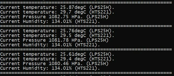

Here are the readings that I got, when the heater on the HTS221 was turned off:

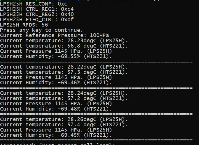

Here are the readings that I got, when the heater on the HTS221 was turned on:

Hi @Faizan Cassim​ , but does the second picture (heater ON) refers to data after the activation or during the heater on? Please note that the datasheet says that:
"valid data can be read out once the heater has been turned off, after the completion of the heating cycle", so you have to read the data after
Not clear also the reference pressure at 100hPa... are you in a low pressure ambient?
About the humidity value: the humidity formula seems ok, but the value is stuck... can you share the regmap dump and the rawHum register values?
Regards
Faizan Cassim
October 21, 2019
Humidity Issue
  • Quiet rightly so, the second terminal screen shot refers to the output humidity; whilst the heater is turned on.
  • How long should 1 heating cycle of the HTS221 take (in seconds or minutes)?
  • Currently the humidity in my area varies from about 89% to 95%.
Pressure Issue
  • The reference pressure is set as zero and the RPDS is at its default value.
  • The pressure in my area, these few days should be around the ballpark of 1006-1010hPa. (As measured on my iPhone)

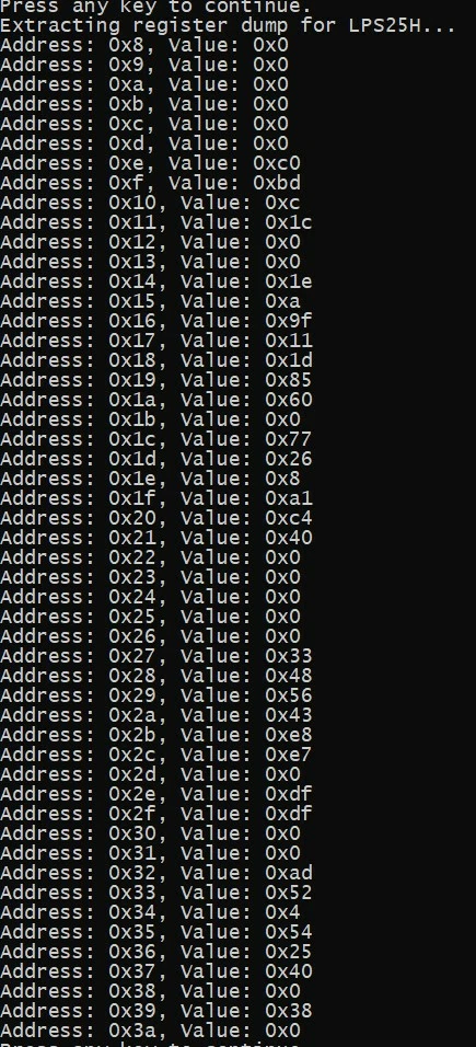

Register Dump for LPS25H

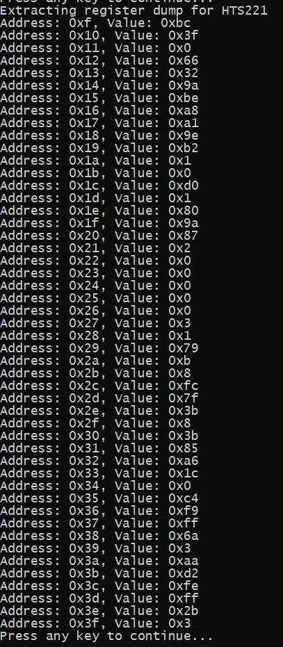

Register Dump for HTS221
