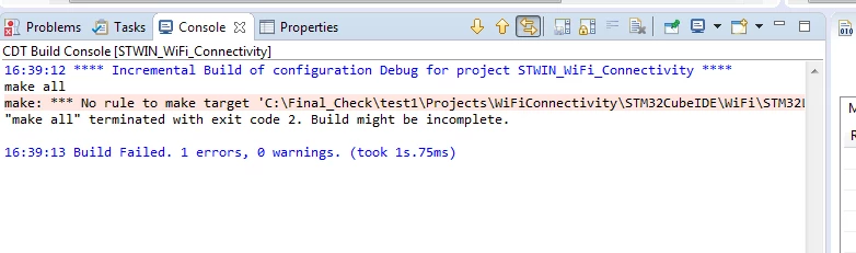

Thank you. I have created a new project and build.But I am getting * No rule to make target error
Eleon BORLINI
September 17, 2020
Hi @AE.2​ ,
there may be some issue in your .ioc creation of the default project of the STWINKT1.
Can you start your project from an already existing example, and add to this your user code? For instance, you can choose the Serial_DataLog SW4STM32 project you can find in \Projects\Serial_DataLog\SW4STM32\STWIN_DATALOG.
-Eleon
