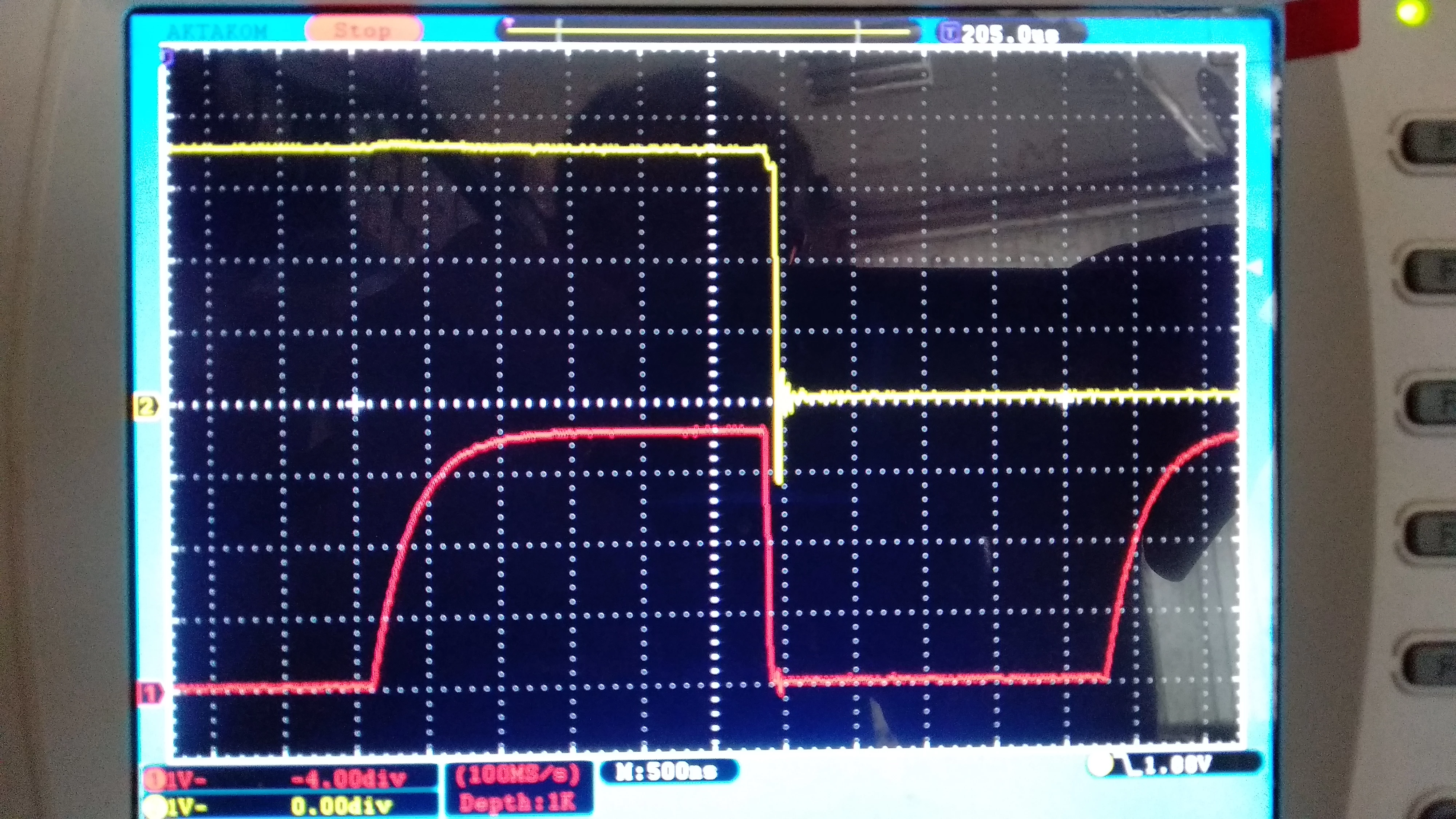

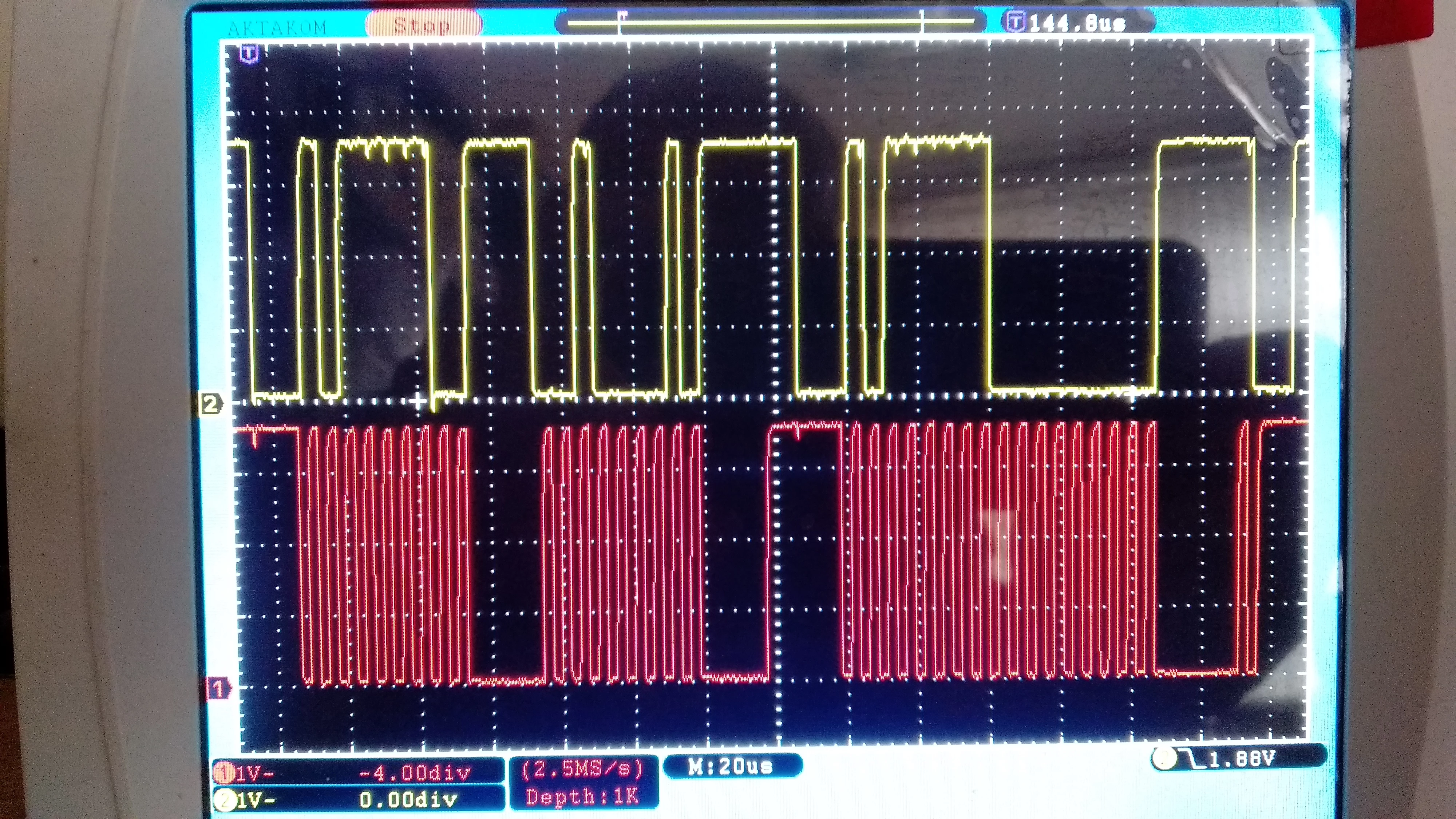

Hi, Eleon.
Ok. Easy!
For example - reading CTRL_REG2 (SubAddress = 0x21) - image 1.
Image 2 - 500nS/dev expansion of point near +60uS on image 1.

Lehman
LehmanAuthor
April 5, 2019
Hi, Eleon.
I can not catch the moment of the SDA line stop in 0, because it happens at a random time.
Best regards.

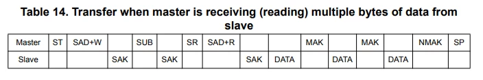

Eleon BORLINI
April 5, 2019
Hi Lehman, so you are building your I2C pattern in bit-banging, right? I'm checking your I2C patter for the multi-byte read case
First data byte is correctly read, while the second one is't. Are you correctly managing the MAK?
Which is the slave addr of the other sensor sharing I2C line, the ATH10?
