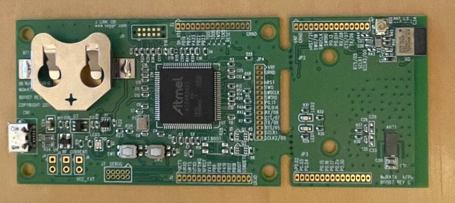

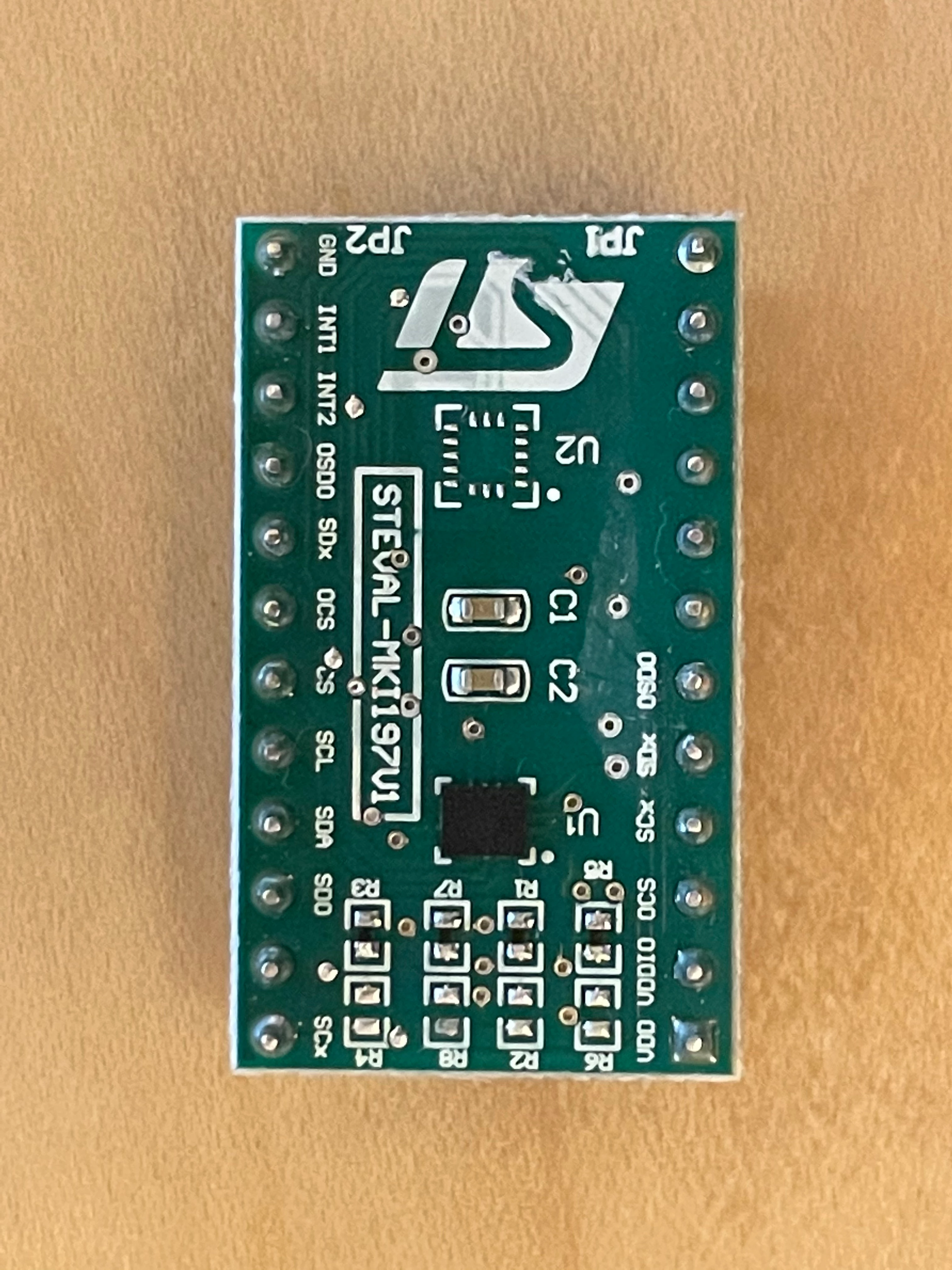

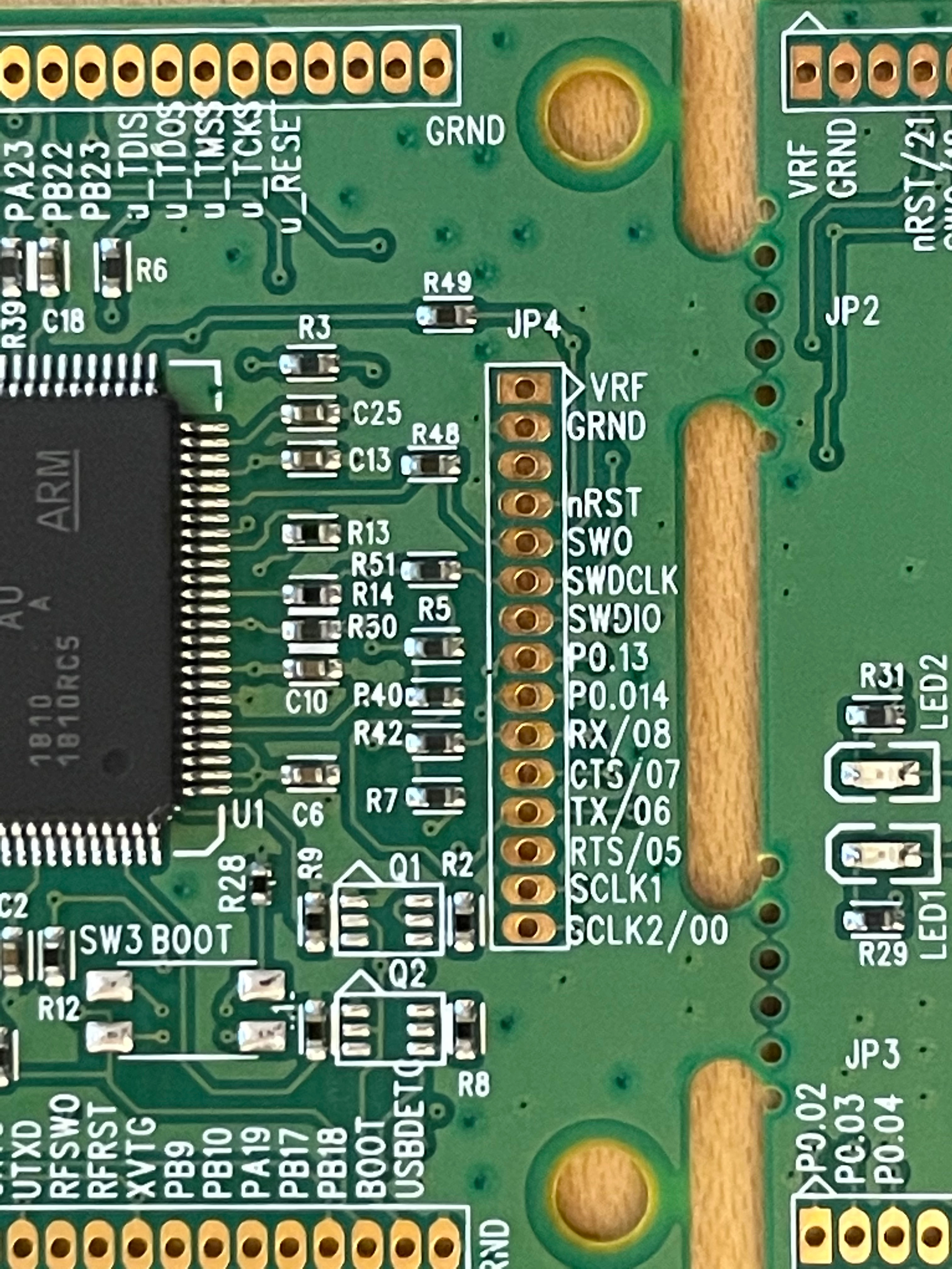

How to wire STEVAL-MKI197V1 to a muRata nRF development board: WSM-BL241-ADA-008DK.
The STEVAL-MKI197V1 has standard breadboard pins on it. The muRata dk (WSM-BL241-ADA-008DK) has available connection points in position JP4 - looks like the right place to attach. Is there a ribbon cable or adapter to connect these two boards together?? thank you! (see photos)

Hi @BGrap.1​ ,
the STEVAL-MKI197V1 -and in general the DIL24 connector of ST sensors' STEVALs- has been designed to be compatible with the STEVAL-MKI109V3 motherboard (and the X-Nucleo expansions for the Sensors).
I don't think that the schematics are immediately compatible, but if you could remap the functions of the muRata nRF according to STEVAL-MKI197V1 schematic, you could make the two boards compatible.
-Eleon

Thanks for the fast reply. We did see the DIL24 connector on the motherboard (STEVAL-MKI109v3) and considered that but thought we would reach out to anyone who might have manually wired them together.
thanks!
