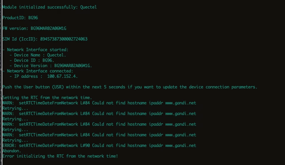

Mar 25, 2021 2:02 PM UTC
Hi @Eleon BORLINI​
I am using STSW-STWINCELL demo application on STEVAL-STWINKT1B with STEVAL-STMODLTE, most of the time I keep getting this error but once in a while it works fine, it connects and sends the topics to AWS.
Can you please help me fix this issue?
SIM which I am using work perfectly fine on my phone, so there is no connection issue.
0693W000008xuVjQAI.pngKind Regards
Chandrashekar C
Eleon BORLINI
Mar 26, 2021 4:04 PM UTC
 Hi @Chandrashekar C​ ,
I checked with our experts and they say that it is unfortunately an issue related to the server chosen for the synchronization with the TLS protocol.
In fact the cellular module is perfectly connected to the net as shown in your picture, with his own IP address.
They suggest the following procedure:
  1. Open the file “main.h�?
  2. Remove the comment at line 90 (#define USE_CLEAR_TIMEDATE             // see 'timedate.c')
  3. Compile again
  4. Download the new firmware.
Please let me know if you can fix the issue in this way.
-Eleon

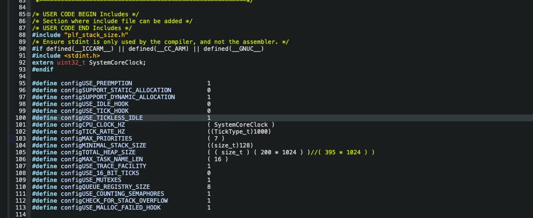

Chandrashekar C
Mar 26, 2021 6:39 PM UTC
Hi @Eleon BORLINI​
Thanks for the response.
I followed the procedure you suggested in the above message, its still same, I doesn't connect at all :( not even once.
Do you think it's anything do with setting Tickless to 1 to achieve Low power mode?
#define configUSE_TICKLESS_IDLE 1
0693W000008y3bHQAQ.pngPlease let me know if I can tweak in anything else.
Kind Regards
