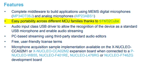

I have taken a closer look at this project and I understand my problem better. But there's something I never understand about this type of project. In the project datasheet (X-CUBE-MEMSMIC1) as well as in many other projects I see this.
Easy portablility across different MCU families ? What does that mean exactly ? stmh7 is included?
Or is it just about the nuclear maps listed at the bottom of the picture?
These libraries (CCA02M1_AUDIO_H + CCA02M1_AUDIO_C) from the project (X-CUBE-MEMSMIC1) are they usable for an stmh7 map if not how to adapt them (if possible).
If I create a project with cubeMX with an h7 nucleo and I add these libraries and update the peripherals (SPI/I2S) it will work?

Hi @UTANG.1​ , this option:
should work. Changing the core STM32 hw will however change also the physical pins declarations in the code libraries. But i believe that our STM32 MCUs colleague are more expert about this topic...
