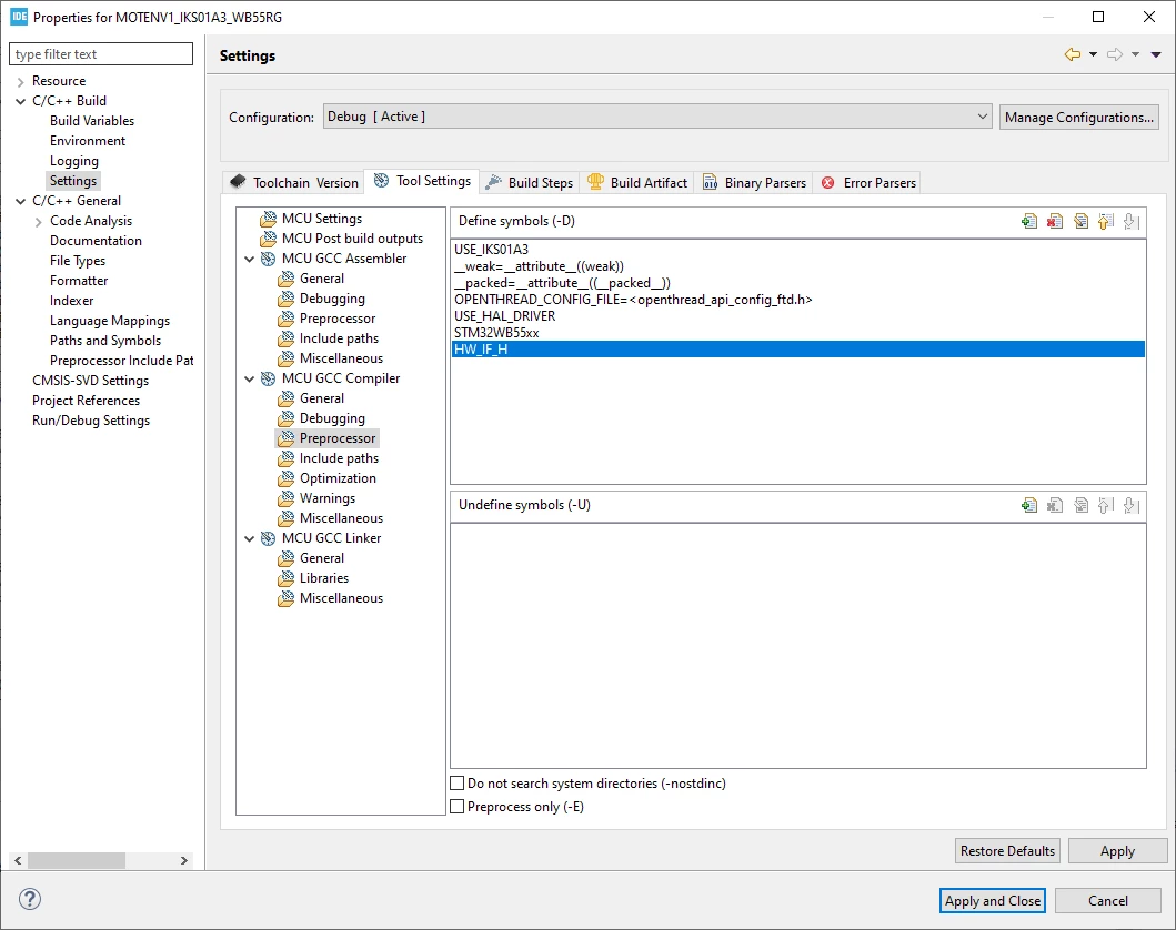

The final solution for me was to use the recursive inclusion prevention define to automatically exclude the content of that file by adding -DHW_IF_H to the compiler definitions. This way I didn't have to edit app_conf.h after each STM32CubeMX regeneration.
Steps:
Go to the project properties
C/C++Build - Settings
MCU GCC C Compiler - Preprocessor
Add HW_IF_H in the Define symbols list:
