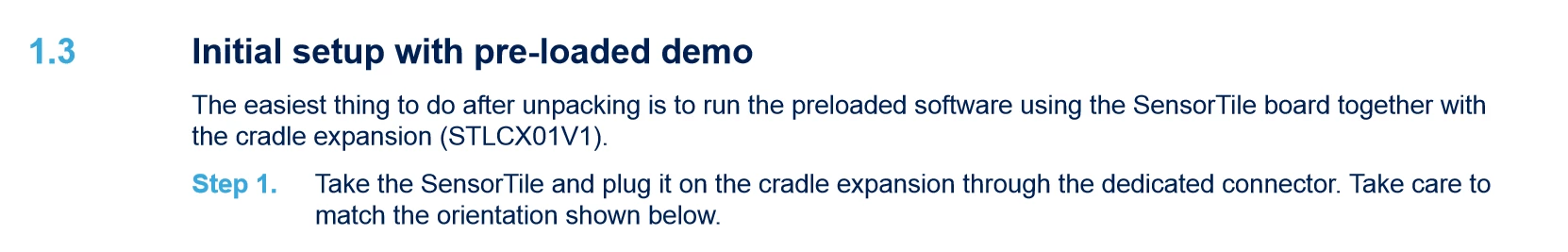

    Kchen.1
    Kchen.1Author
    March 17, 2020
    Thanks for your reply!
    The handbook of STEVAL-STLKT01V1 SensorTile says there is a demo have pre-loaded in the SensorTile board. As screen capture below shows.
    I downloaded the new code in the board, so that demo code has been erased. I'd like to get that demo and download it again.
    Best wishes!
