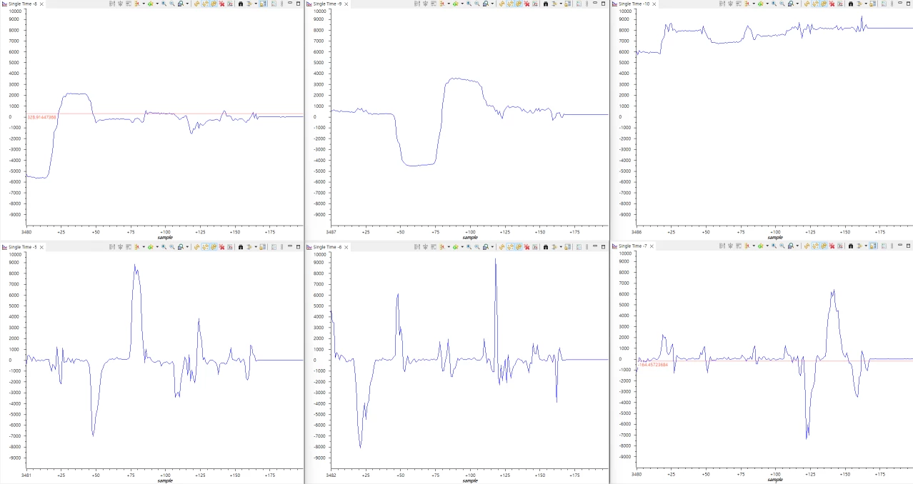

I am using LSM6DSO32X using SPI communication in TI AM2634 Chip.
By default, I made a packet of Ctrl1_xl and Ctrl2_xl to 0x10b0 0x1110, and the Accel data and GYRO data were output.
I saw Datasheet, but it's too hard to understand what each register is playing.
Can you tell me the appropriate Register setting example?
Can you tell me how to use LPF?
The figure shows the data output to my register settings.
From the top left, Accel X, Y, Z, Gyro P, R, Y.
Also, how do you correct each Accel value and GYRO value?
Do I have to implement it in my own software?
Thank you

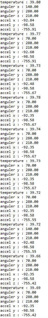

sygoAuthor
November 14, 2023
Sorry, but I have one more question.
I had success implementing it on other platforms using PID.
But I don't know if this is the right value.
I used the lsm6dso32x_offset example of PID.
The picture below is when the board with IMU is stationary.
Are these values ​​correct?
Thank you
