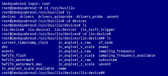

How to use IIO triggered buffer?
0693W00000ANUmLQAX.pngI use ASM330LHH as Linux IIO.
Source and DTS were added.
We found that /sys/bus/iio also added a device.
I also checked reading data in direct mode from sysfs.
Therefore, I think there is no problem with the H/W connection.
I want to use Trigger mode to read multiple data, but I don't see trigger and buffer in Directory.
I tried the # echo 0> /sys/devices/iio_sysfs_trigger/add_trigger command, but I still don't see trigger.

Hi @Simon.Ko​ ,
Are you using the drivers on Github developed by ST --> st_asm330lhh?
In this case, the triggered buffer mode is not supported by the driver, because it uses only the FIFO interrupt, and not the external trigger.
It is possible to modify it, but in case you are using the Github drivers and you need direct help you can open an issue directly on Github (link), so that our experts can track the request and support it.
