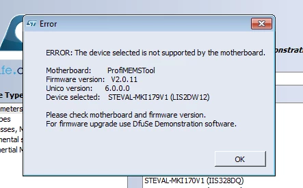

Hi, I downloaded the Unico 6.0.0.0 and selected the STEVAL-MKI179V1 for
LIS2DW12
sensor. I am using the
motherboard STEVAL-MKI109V3 and i getting the same error. How to solve firmware issue for this motherboard?
I have attached the snapshot of my error here in this question.
Looking for a quick response.
Thank you

Please update the firmware in your STEVAL-MKI109V3 boards.
The latest FW is in DFU directory, together with the instructions how to do it, in
/external-link.jspa?url=http%3A%2F%2Fwww.st.com%2Fcontent%2Fst_com%2Fen%2Fproducts%2Fembedded-software%2Fevaluation-tool-software%2Fstsw-mki109w.html
package.

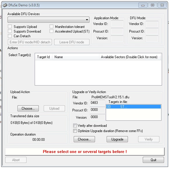

Hi, I have downloaded the package and installed everything. Then, i tried to upload the .dfu file for the
STEVAL-MKI109V3 board following the instructions. Here is the process i did. Please correct if i am wrong.
1. I installed the driver for the board and driver got installed in COM4 port of my laptop.
2. Then, i installed both DfuseDemo and Unico software.
3. Then, i connected the board to my PC and tried to upload the file ProfiMEMSToolV2.15.1.dfu.
Is this is the file to upload in the
STEVAL-MKI109V3
board to update the firmware?
However, when i chose this file using DfuseDemo, the file does get loaded correctly but does not get uploaded. It says me to select a target but there are no any files in the target box. Here is the screenshot of what it says.
Please provide me a needful suggestion here.
Thank you

The board does not appear to be in DFU mode, make sure whatever jumpers need to be set to get BOOT0 pin of processor high are set. Board will likely need to be reset or reconnected after changing settings.
The available devices box needs to list 'STM32 in DFU Mode' type item, this needs to be selected as the 'Target'
