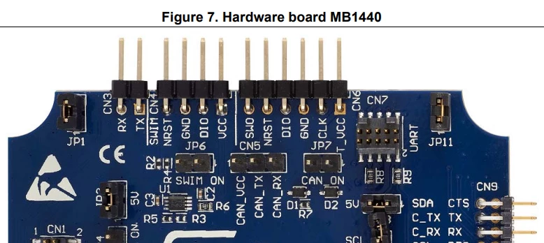

    I now have the STLINK V3. What I can't figure out is how to connect it to my SensorTile. Is there an explanation somewhere as I'm struggling to see which pins for anything feasibly connect to each other.

    Hi @JBrad.4​ ,
    you have to connect the CN6 connector of the ST LINK V3 shown in the picture below
    to the 5-pin SWD connector for programming debugging on the Sensortile cradle expansion (STLCX01V1), p.9 of the user manual UM2101, through a flat cable.
    0693W000005COS8QAO.pngPlease assure that the SWD pin on the first connector is linked to the SWD on the second connector.
    You can also use the SWD connector on the cradle device STLCR01V1.
    -Eleon

    Hi @JBrad.4​ ,
    I have an update... you have to use the level shifter on the B-STLINK-VOLT board extension to program the Sensortile at 1.8V, since this is the running voltage of the Sensortile STM32L4 uC. But being the connector of this board a STDC14 connector, you should adapt this to the a standard pitch SWD connector of the Sensortile cradle.
    Otherwise, you have to use the STLINK V2 or any X-NUCLEO board, that are provided of an embedded STLINK.
