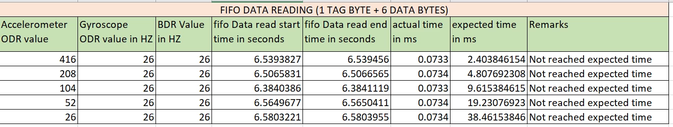

hi,
I am using lsm6dso module.
I have configured with 26hz output data rate using accelerometer control register.
I am reading data from fifo registers in lsm6dso.
expected data rate speed : 1/26hz = 38.4615 milli seconds.
Actual data rate speed : Around 100 micro seconds. this is too fast. I need to slow down the data rate. could you please let me know the solution for this.
TEST 1: accelerometer configured with different ODR values and gyroscope configured with 26 HZ output data rate
 TEST 2: accelerometer and gyroscope configured with same output data rate values (ODR )
Regards,
Srinivas

srao.1
srao.1Author
December 9, 2020
Hi Eleon BORLINI,
Thanks for response. please have the details of my environment and provide solution for slow down the data reading rate
Actually we are reading 7 bytes ( 1 tag byte and x-y-z 16-bit accelerometer pattern ) from fifo.
Is there any formula to calculate total rate based on Accelerometer ODR (output data rate) value?
where can we refer this formula ?
As per given formula, (1/ODR)/16*3
For the given example of 26hz ODR , we are getting around 800us not 80us as below
(1/26)/16*3 = 38.5ms/48 = 802us

srao.1
srao.1Author
December 9, 2020
Hi Eleon BORLINI,
Please check attached table for more information.
Eleon BORLINI
December 10, 2020
Hi @srao.1​ ,
ok... but are you filling the FIFO up to a certain threshold (for example tag+3 axis values) and then reading the batch of FIFO data all together, right? If so, the speed of the reading depends on the speed of your SPI or I2C, and is uncorrelated with the ODR, because you are reading data already saved in memory. In this case, the 73ms you see are given by 1/(SPI-I2C clock frequency) * (16*3 + 8), the 7 bytes you are reading from the FIFO every time.
Could you also share the read acceleration data (+ tag) that you are reading from the FIFO?
If you want to read at 26Hz (or configured ODR speed), you don't need to go in FIFO mode, but you can just red the output registers in polling mode (lsm6dso_read_data_polling.c) or synchronously with the DRDY interrupt (lsm6dso_read_data_interrupt.c).
