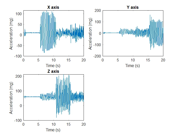

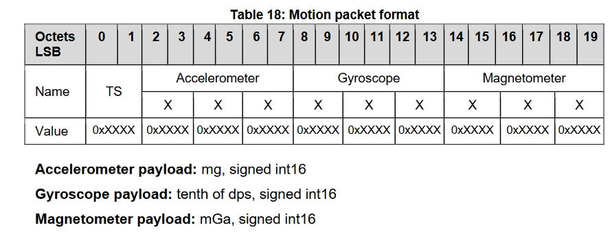

Just for anyone else with this problem- I have a solution:
(1) Connect to device and setup characteristic:
 WESU = ble("WeSu");
chr = characteristic(WESU,"00000000-0001-11E1-9AB4-0002A5D5C51B","00E00000-0001-11E1-AC36-0002A5D5C51B");
We are connecting the "00E00000-0001-11E1-AC36-0002A5D5C51B" characteristic which is an aggregate of the movement sensors. It follows this form:
X = read(chr)';
% where:
X' = [73 4 246 255 156 3 182 1 214 255 136 1 18 254 30 0 201 254 194 1]
(3) As you can see in the figure above, we need to access Bytes 2-7 for the accelerometer, and convert from the native unsigned 8-bit integers ("unit8") that MATLAB reads in, to signed 16-bit integers ("int16"):
XYZ = double(typecast(uint8(X(3:8)),'int16'));
(4) Finally, convert to engineering units, following the formula helpfully sourced in the comment by Eleon, above:
XYZ = (XYZ.*61)/1000;
You can see the output below:
0693W00000FBPJFQA5.pngGood luck!

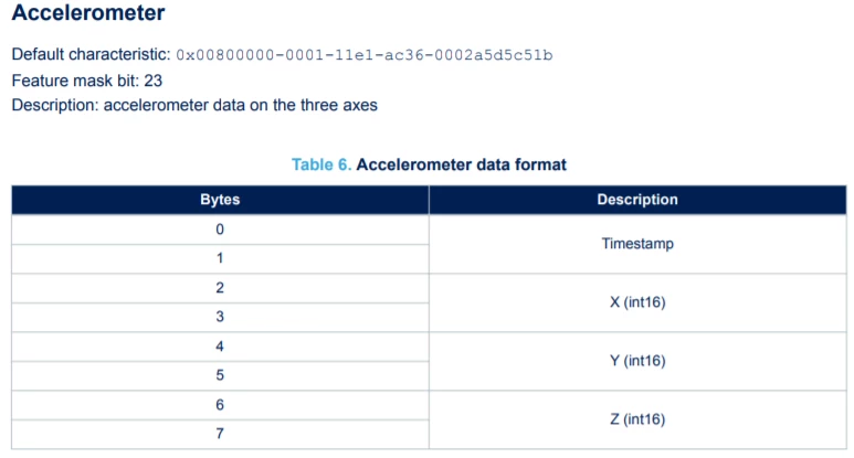

Hi Tim @TWest.3​ ,
Let me try to answer your question here below:
(A) The characteristics looks correct, you could try to require only the 3 axis data using the following string --> 00800000-0001-11E1-AC36-0002A5D5C51B
0693W00000Dm0SXQAZ.png(B) The accelerometer (IMU) mounted on the STEVAL-WESU is the LSM6DS3, so you can refer, for example, to the C drivers on Github for an easy conversion formula from the LSB units to the physical ones (see lsm6ds3_reg.c)

Hi Eleon, thanks again for the response.
(1) Thanks for confirming the characteristic- I have swapped to the UUID you suggested.
(2) Thanks for tracking down the conversion - I understand this will take a 16 bit integer and convert it into the physical units of the sensor. However, I am still stuck with regards to how I reconstruct the 16 bit integer from the raw data that I read from the device.
I read in the data with the above characteristics:
device = ble('WeSU');
chr = characteristic(device,"00000000-0001-11E1-9AB4-0002A5D5C51B","00000080-0001-11E1-AC36-0002A5D5C51B");
X = read(chr)';
This yields a 20x1 double. e.g.:
X = [ 85 15 139 217 82 63 41 148 214 190 87 167 170 190 251 70 63 62 0 0];
However, table 6 you sent above makes me expect a vector of 7x1.
his is where I am stuck - how do I convert this into the correct format. I figure this list is a set of 8 bit integers that I should convert to 16 bit integers, using MATLABs typecast function which converts from uint8 to uint16 by parsing the vector in pairs:
 ACC= double(typecast(uint8(X(bInts)),'uint16'));
This however isn't yielding any sensible output that conforms to movement - I figure I am reading something in the wrong order?
Thanks again for your assistance.
-Tim
