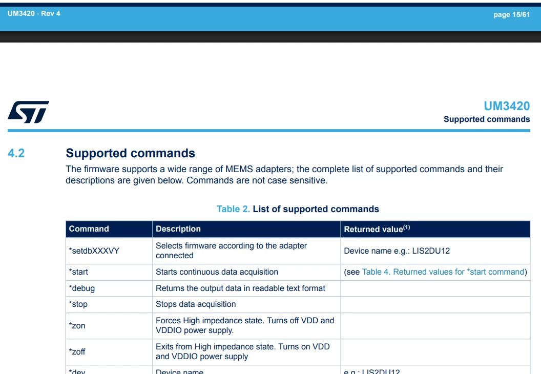

How to read IMU information using STEVAL-MKI109D?
I connected STEVAL-MKI236A and STEVAL-MKI109D and confirmed that the IMU information comes from Mems studio and Unico.
My final goal is that this IMU value is output in serial communication.
I want to read the output IMU 6-axis information through python and match it to ros2 topic.
Please teach me the way.
Thank you. Have a nice day

The list of commands supported by the STEVAL-MKI109D is in the User Manual:
https://www.st.com/resource/en/user_manual/um3420-stevalmki109d-professional-mems-tool-motherboard-for-mems-adapter-boards-stmicroelectronics.pdf#page=61
via: https://www.st.com/en/evaluation-tools/steval-mki109d.html#documentation
Or you would have to write your own firmware for  the board.

Hello
I'm testing how to read acceleration and gyro values in serial through the method you told me.
After setting the command *setdb236A, *zoff, I tried to read the data stream value through *debug, *start, but there was no response.
I checked through the command *help and found that the values can be retrieved and read through *ZrXX, but I didn't see the command *start, *debug in *help. Is this a firmware version problem?
My version is V1.5.3.
Data is currently available only with *ZrXX.
