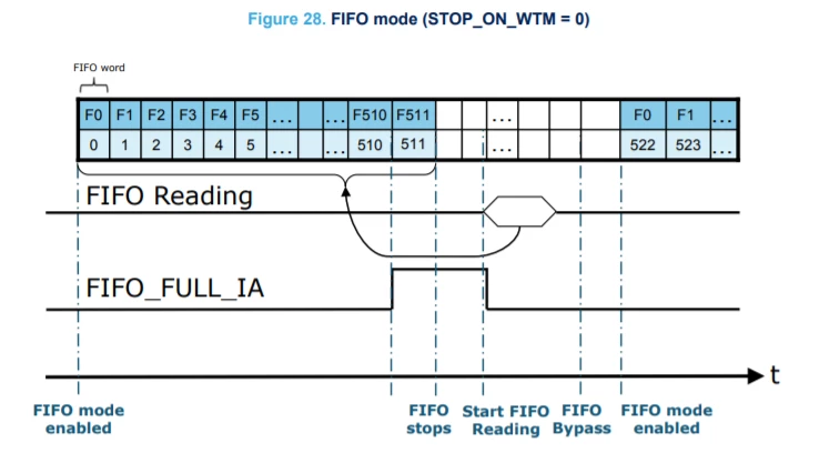

Eleon BORLINI
December 20, 2021
Hi @Sprem.1​ ,
In absence of specific details about the issue, would first suggest you to read LSM6DSOX application note, FIFO modes, from p.101.
0693W00000HpDgjQAF.pngYou can then have a loot to the Github examples in C, such as the lsm6dsox_fifo.c: these drivers implements the registers' settings, buffer reading and parsing in order to implement the FIFO mode on the LSM6DSOX.
If my reply answered your question, please click on Select as Best at the bottom of this post. This will help other users with the same issue to find the answer faster.

Hi, eleon,
can we say whether this FIFO setting is correct?
FIFO_CTRL1(07h) - 0x00
FIFO_CTRL2(08h ) - 0x00
FIFO_CTRL3(09h) - 0xA0(gyroscope - 6667Hz)
FIFO_CTRL4(0Ah ) - 0x01(FIFO mode)
COUNTER_BDR_REG1(0Bh) - 0x00
COUNTER_BDR_REG2(0Ch) - 0x00
time sleep - 6ms (collecting 40 samples)
Eleon BORLINI
December 22, 2021
Hi @Sprem.1​ ,
It should be OK, setting the FIFO mode this way. However, please pay attention to the gyro speed, which is quite high and which could cause the FIFO filling to fast without time to read it.
Otherwise, if you are facing issues, please try the online example (with your personal ODRs):
 * Set FIFO watermark (number of unread sensor data TAG + 6 bytes stored in FIFO) to 10 samples
 lsm6dsox_fifo_watermark_set(&dev_ctx, 10);
 /* Set FIFO batch XL/Gyro ODR to 12.5Hz */
 lsm6dsox_fifo_xl_batch_set(&dev_ctx, LSM6DSOX_XL_BATCHED_AT_12Hz5);
 lsm6dsox_fifo_gy_batch_set(&dev_ctx, LSM6DSOX_GY_BATCHED_AT_12Hz5);
 /* Set FIFO mode to Stream mode (aka Continuous Mode) */
 lsm6dsox_fifo_mode_set(&dev_ctx, LSM6DSOX_STREAM_MODE);
 /* Enable drdy 75 μs pulse: uncomment if interrupt must be pulsed */
 //lsm6dsox_data_ready_mode_set(&dev_ctx, LSM6DSOX_DRDY_PULSED);
 /* Set Output Data Rate */
 lsm6dsox_xl_data_rate_set(&dev_ctx, LSM6DSOX_XL_ODR_12Hz5);
 lsm6dsox_gy_data_rate_set(&dev_ctx, LSM6DSOX_GY_ODR_12Hz5);
-Eleon
