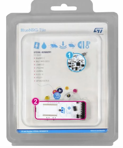

I've just bought a STEVAL-BCN002V1B (BlueNRG - Tile), with the host board to Flash and debug, and i would like to know how i can easily program it.

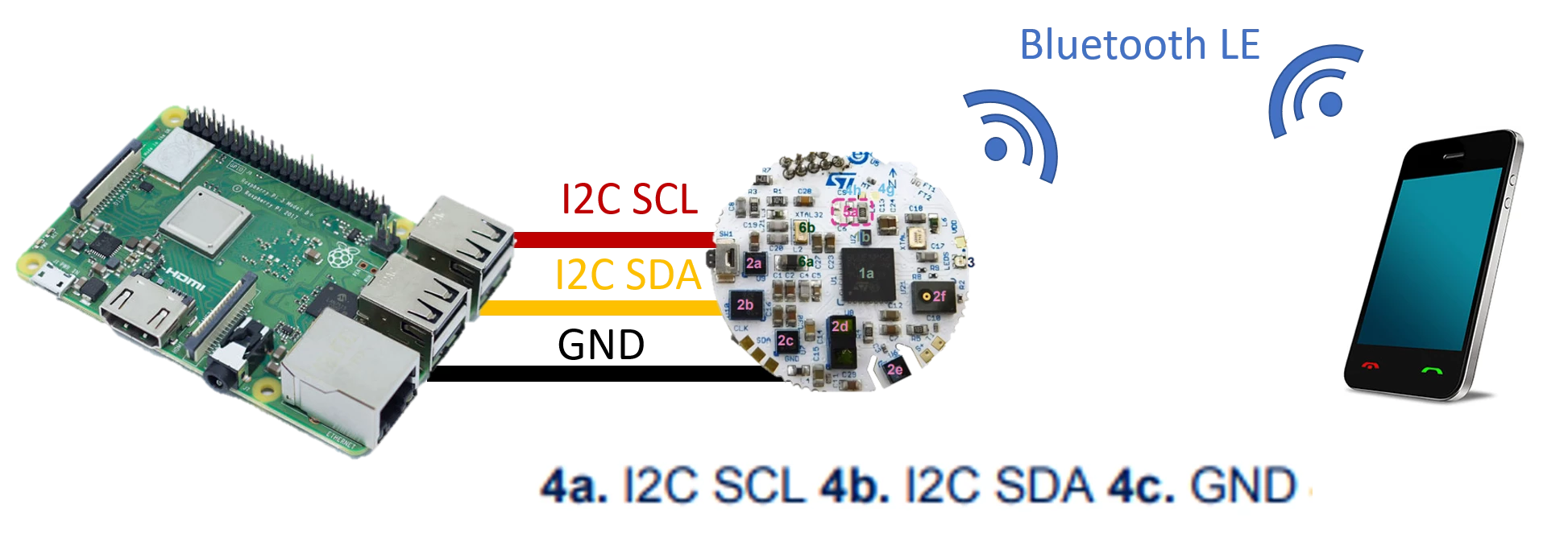

  4. My ultimate goal would be send/receive information from a cellphone with my BlueNRG - Tile and transmit this via I2C (or UART, or SPI) to a Raspberry Pi. Any idea how this can be done?

    Hi Danilo @DDi L.1​ ,
    If you want to create your own firmware and upload it on the Bluecoin, please note that the STEVAL-BCN002V1B device kit contains the STEVAL-BCN002V1D programming board (the N.2 in the first picture you shared): the usual way to program the sensor board (the STEVAL-BCN002V1 one, N.1, the Bluetile) is to connect the JTAG/SWD for Nucleo ST-LINK of the STEVAL-BCN002V1D to an STLINK (V2 or V3) and to the PC and follow the standard indication using for example the STM32 CubeProgrammer free IDE. You can also directly connect the STLINK-V3 to the Sensor module (STEVAL-BCN002V1), as described in the Databrief, p.2. This standard procedure is described for example HERE.
    For the connection between the STEVAL-BCN002V1 and the smartphone, you can simply download the ST BLE Sensor app and connect with your Bluetile.
    For the connection between the STM32 on the Bluecoin and your Raspberry, this could be a little more complicated... while for the streaming of the data on USB (to a PC) you can simply use the and use, for example, an hyper-terminal emulator (V-COM reader such as Tera Term) to print the data at screen.
    If however you want to use for example the Python programming language for the both programming the STM32 and for managing the data streaming from the sensor board, I suggest to refer to this tool: MicroPython for STM32. Browsing this page, you should find examples on Github that can run on the STM32Lx family (even if -unfortunately- there are no examples perfectly matching the Bluecoin hardware configuration, i.e. the STM32L151 uC).
