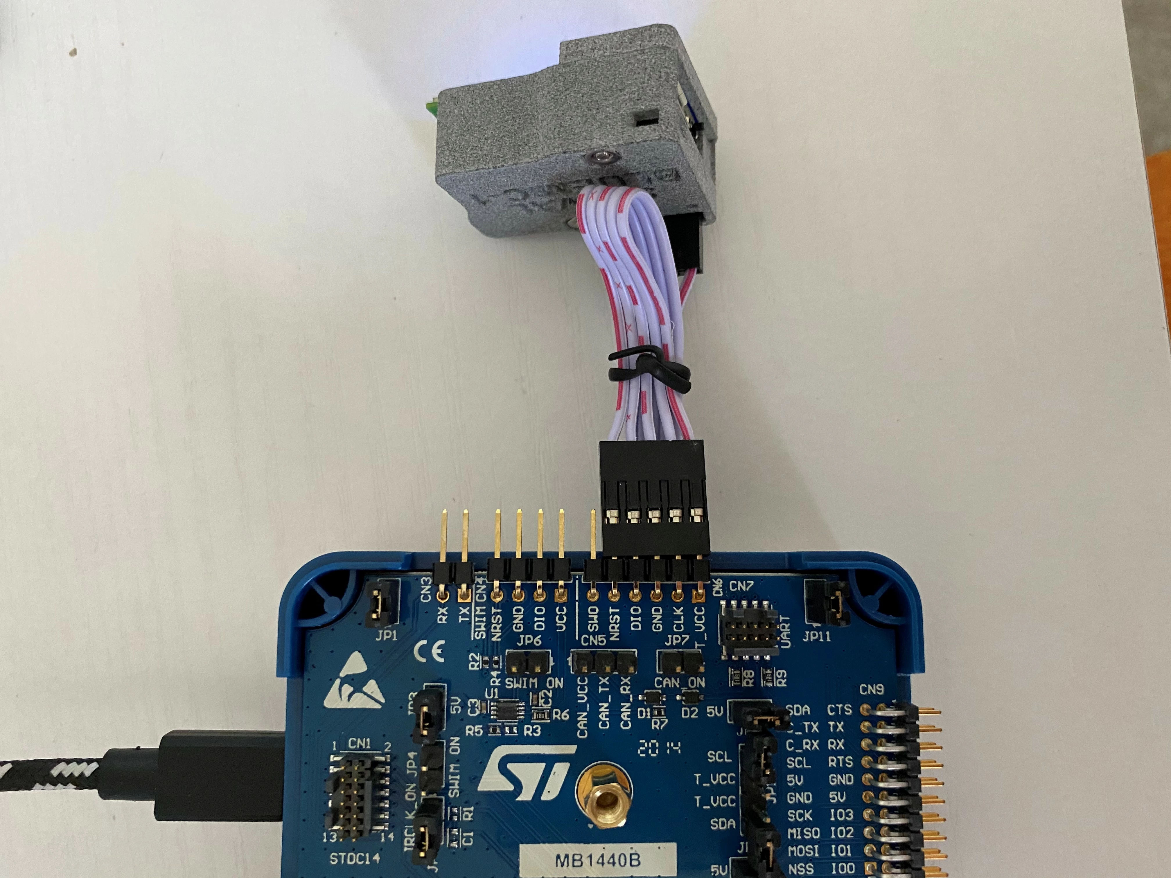

I have connected the STEVAL-BLUEMIC-1 board to the STLINK-V3 debugger using the SWD cable (see below).
I am using the STM32CubeProgrammer software. I updated the firmware on the STLINK-V3, and the power light is green and the COM light is red on the STLINK-V3. The STEVAL-BLUEMIC-1 board is powered on. When I click the "Connect" button, I get the following error.
How can I resolve this error?

Hi @SHack.1​ ,
Uhm... I have some question for you:
  • Can you check the voltage on the T_VCC pin? And did you disconnect the Li-ion battery before running the upload?
  • Can you please also check that the SWD cable is connected in the right orientation?
  • Did you do the full chip erase before the firmware upgrade?
-Eleon

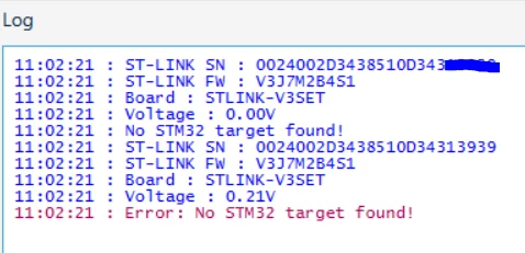

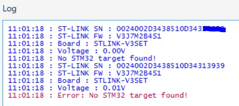

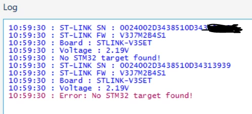

  • I tried to connect to the BLUEMIC board with and without the Li-Ion battery. Below are my error logs and the value of T_VCC for each case.
    • BLUEMIC with battery connected and powered On
      • T_VCC=2.19V
      • Error log: 0693W000004KI9MQAW.png
  • BLUEMIC with battery connected and powered Off
    • T_VCC = 0V
    • Error log: 0693W000004KI9bQAG.png
  • BLUEMIC connected without the battery
    • T_VCC = 0.001V
    • Error log: 0693W000004KI9gQAG.png
  • The SWD cable is connected in the right orientation. The CLK, GND, and DIO pins on both the BLUEMIC board and STLINK board are connected.

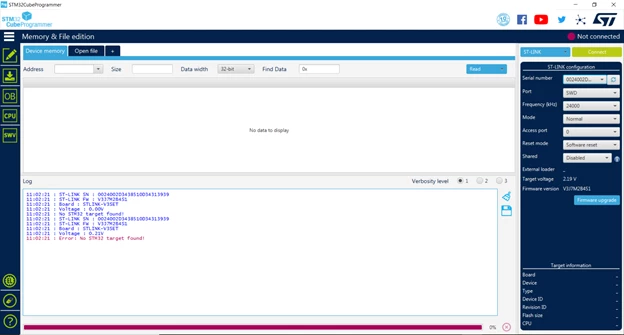

Here is a screenshot of what the STM32CubeProgrammer looks like. 0693W000004KIBDQA4.png
