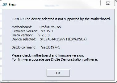

The STEVAL-MKI109V3 datasheet says that it supports the LSM6DSOX on the STEVAL-MKI197V1, but I get the following error in UNICO GUI saying that it is not supported by the motherboard.
Any idea how I should troubleshoot this?

    ​Hi @DLim.16​ , first of all make sure you plugged the dil24 in the correct orientation on the ProfiMEMS tool, and which LEDs are ON on the motherboard. From a FW p.o.v., you should also check which .dfu version you downloaded on the STEVAL-MKI109V3. Is it the ProfiMEMSToolV3.6.4.dfu? You can find it at folder ...\MEMS_Demonstration_Kit_SW_package_v9_2_WINDOWS\DFU\ProfiMEMSTool board. If you are already here, you can check if Unico connects the Steval selection LSM6DSO (and not DSOX) and, finally, if still not working you should send me the picture of the top side of the device package, to check if it is correctly a DSOX. Regards
