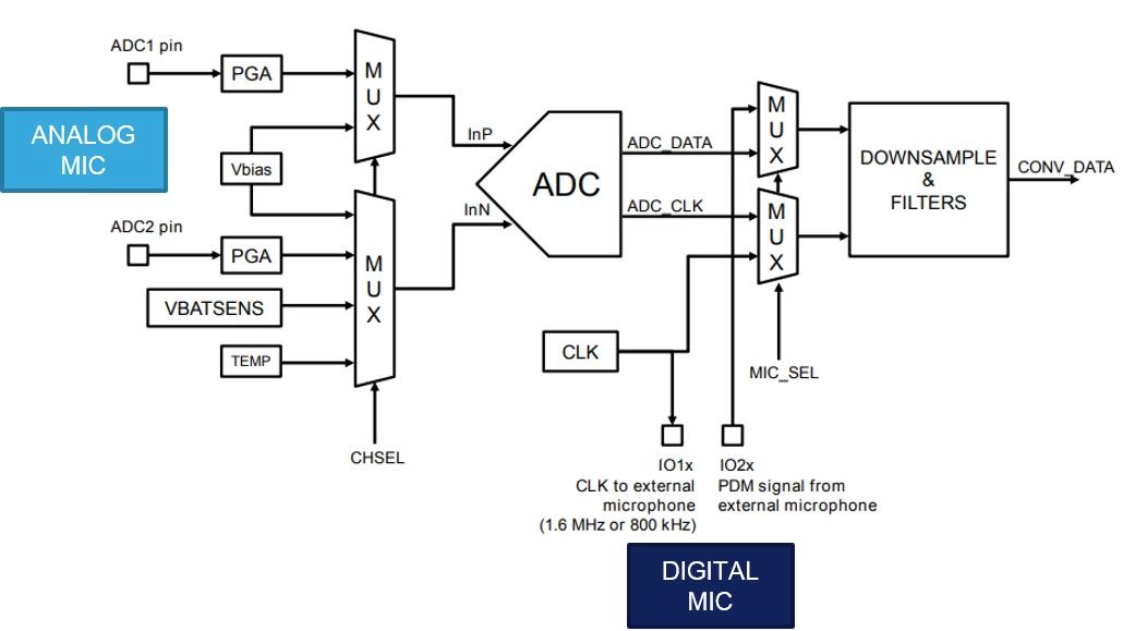

How to Interface MEMS Microphone to BlueNRG-2..? Is it Either Using IO pints or ADC.? Can anybody share the reference?

I need to connect Microphone to BlueNRG-2 and How Can I interface with the Chip.?

    ​hi, it depends on the microphone you are using. If the mic is analog (differential or single ended like MP23ABS1), you have to interface it to ADC pins (ADC1 and ADC2 --> OUTP and OUTN). If the mic is digital (e.g. MP34DT05-A) you can directly connect it to PDM interface (IO1x and IO2x pins --> CLK and DATA)
    Because of it's a 10bit ADC, if you are interest to a good SNR I suggest you to use a digital microphone.

    Dear Eleon,
    Thanks for the input and yes I am using digital MIC. so I can connect directly to any IOx pin which has PDM functionality as per the GPIO table right.?

    ​yes, you're right. You can use IO pins in Serial2 mode that support PDM (up to 2 mics per line, if working in stereo mode). Regards
