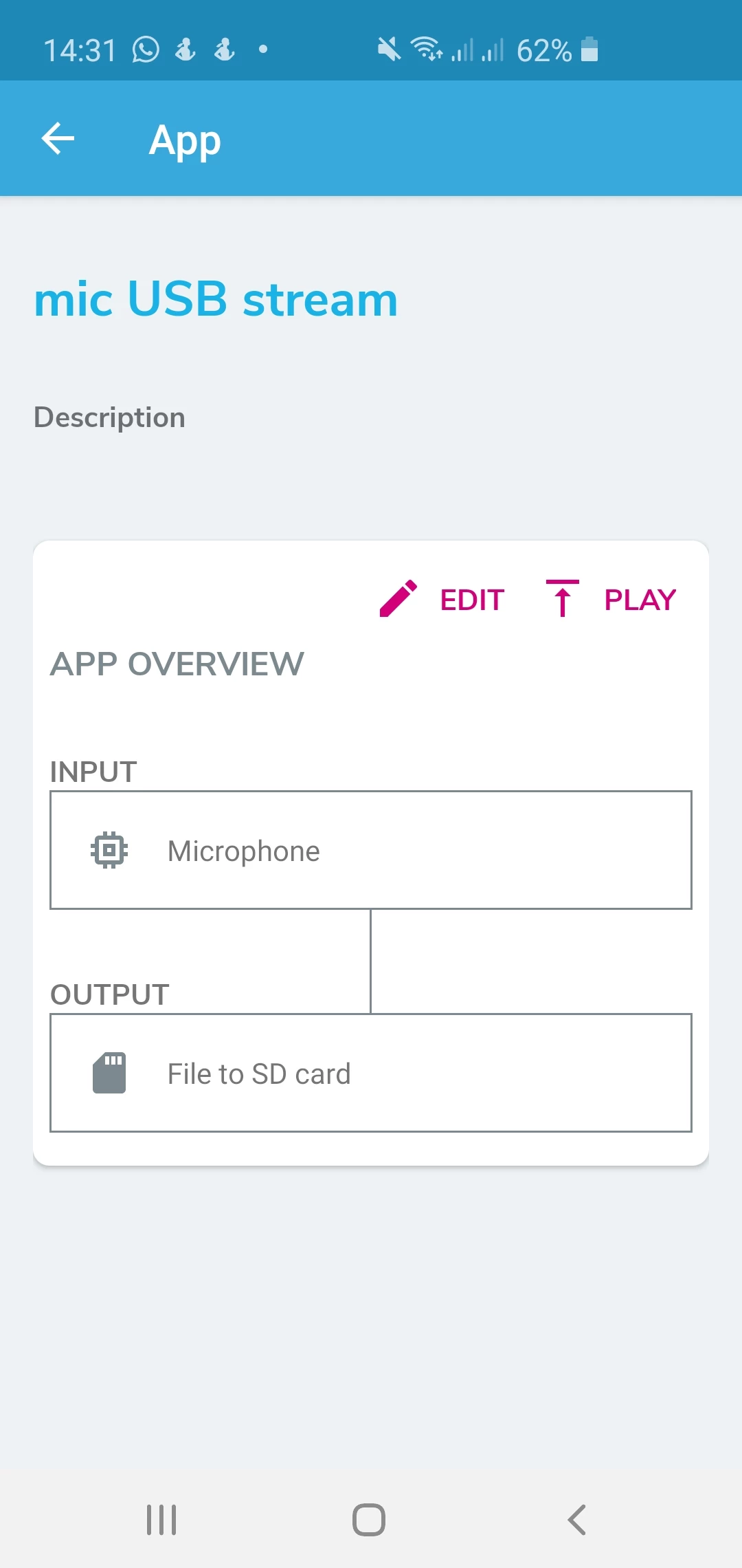

    Eleon thanks for your reply, i have been using steval mskbox1v1 evaluation module i tried microphone as input and used all combinations of the functions and saved it on the sd card but I'm unable to save it in .wav all i could get was,
    .CSV file please help me with the issue.

    Hi Mardi, try to simplify your app as shown below, run the acquisition for some seconds and then check the SD card (the PC recognize the mskbox1v1 as a mass storage device when it is not connected to the bluetooth).
    Regards
