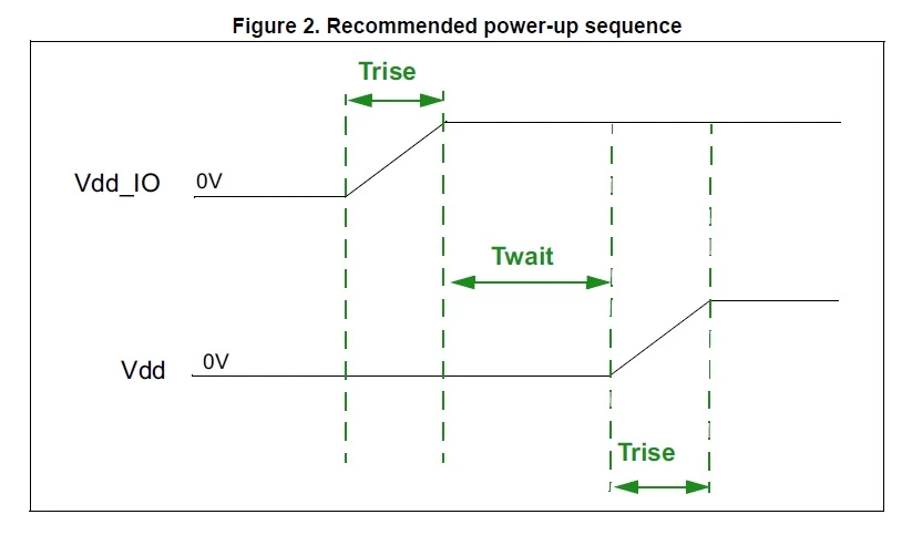

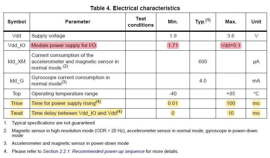

Hi, I am reading the datasheet of LSM9DS1 and it says that there are two times (rise and wait) you should respect

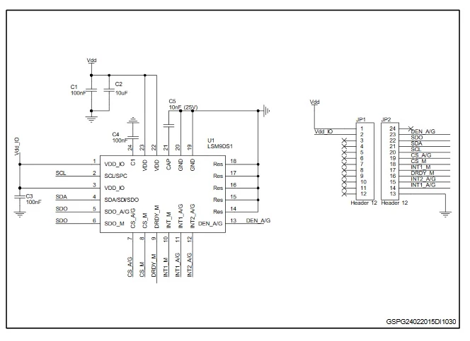

I was thinking in a sequencer IC but if we see the schematic of the LSM9DS1 evaluation board (STEVAL-MKI159V1) it does not use any kind of external IC to control the power up time, they just connects the Vdd and Vdd_IO directly to the power supply, why?, is there no consequence in supply the IMU without meet the requirements of the datasheet?, thanks

Hi @jg_spitfire​ , considering the schematic of the STEVAL-MKI159V1 you posted above, there is no short path between Vdd and Vdd_IO: the two lines are separated and are supposed to be tied to a couple of application processor (uC) pins: this is coherent with the sequential power-on scheme of the datasheet. What I however can tell you is that 99.9% of the times you will not encounter issues in connecting together the Vdd and the Vdd_IO lines (but in this way you will maybe have a little extra current consumption in power down), provided that your Vdd / Vdd_IO ramp is not too fast (<< Trise). Regards

Hi, so I understand that I should implement the delay between the two pins, I am thinking in use a soft start LDO for each pin because with the uC I can not control the Vdd_IO rise time, what do you think?, is there any datasheet with that circuit reference? , thanks
