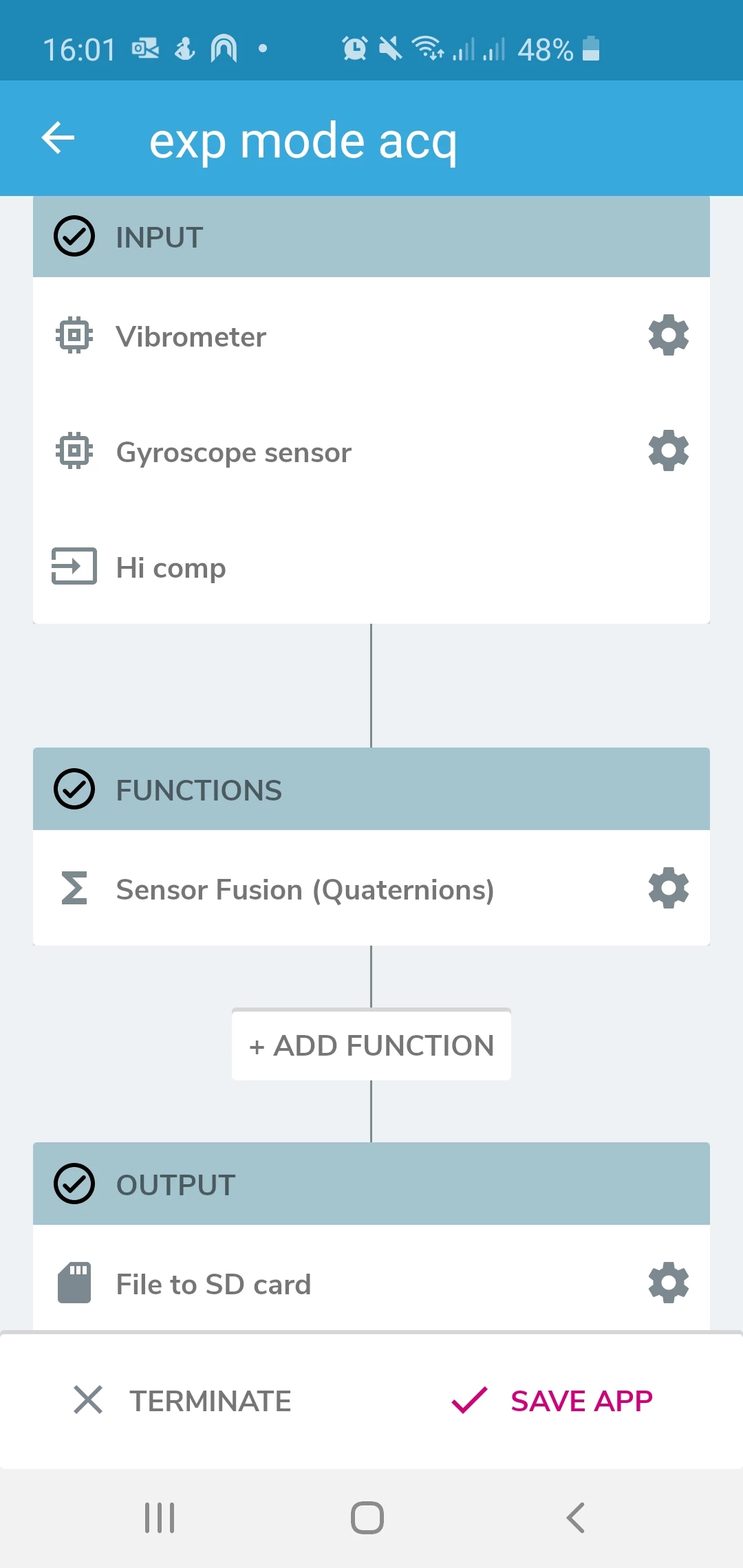

Hello All,
I have been planning on a project around the sensortile box. For this project I wanted to use multiple sensortile box modules and have each of them send their heading directions via bluetooth to a master PC or a HUB.
I am aware of the FP-SNS-ALLMEMS function pack that has an E-compass mode amongst other things. However I am not sure how I can use this library to send only the heading direction of each sensortile.
I was hoping that someone could provide me some guidance on where to start and what libraries or resources may be useful for my project.
Any tips or help would be much appreciated.
Thanks in Advacne,
VRao1
1 reply
Eleon BORLINI
March 6, 2020
Hi @VRao.1​ , please find attached my answers below:
>> for this project I wanted to use multiple sensortile box modules
You can only pair a device and a ST.box per time: if you
You can and select the Euler angles or the Quaternions from the functions in expert mode and you can check the graphs directly on the apk or stream the data on the SD card or on your PC via USB (if you just want the raw data).
