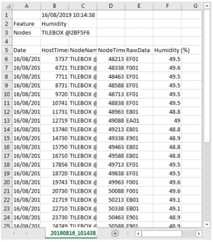

How to extract rawdata of sensortile.box . I have received the csV file.. How to understand the data value Date HostTimestamp (ms) NodeName NodeTimestamp RawData Humidity (%) 50:13.1 836 TILEBOX @541833 3131 7502 62.9 How to decode the rawdata

    Hi @Snara.2​ ,
    you can find an explanation in this presentation, p.133, for the Humidity sensor.
    In particular, the csv datalog formatted in excel should look like the following:
    0693W00000Bd4iQQAR.pngThe fist column is the date, and you should format it as a date in excel; then the host time in millisecond (this value can be used as time axis in an x-y graph), is the time from which the device is operating; then the node name and the node time stamp; and finally you have the relevant data, i.e. the humidity raw data in decimal (7502 dec = 1D4E hex) and the physical percentage value 62.9%.
    The last value is calculated according to these technical note indications.

    Hello, how are you? I was looking at how to interpret the RawData in this case and seeing the technical note indications I am not clear.
    At the same time, I'm seeing how to interpret the RawData in the accelerometer, since I don't understand it. At first I tried with the microphone and it was very simple, since I only had to convert from HEX to DEC and I got the MIC_LEVEL in dB.
    Could you clarify the case of humidity, and more importantly the accelerometer, please.

    Hi @SAbba.1 ,
    for the conversion between LSB (raw data) and physical data for accelerometers, you can refer to the github repository of the C drivers. For example, for the LIS2DW12, you can refer to the file lis2dw12_reg.c:
    float_t lis2dw12_from_fs2_to_mg(int16_t lsb)
    return ((float_t)lsb) * 0.061f;
    -Eleon
