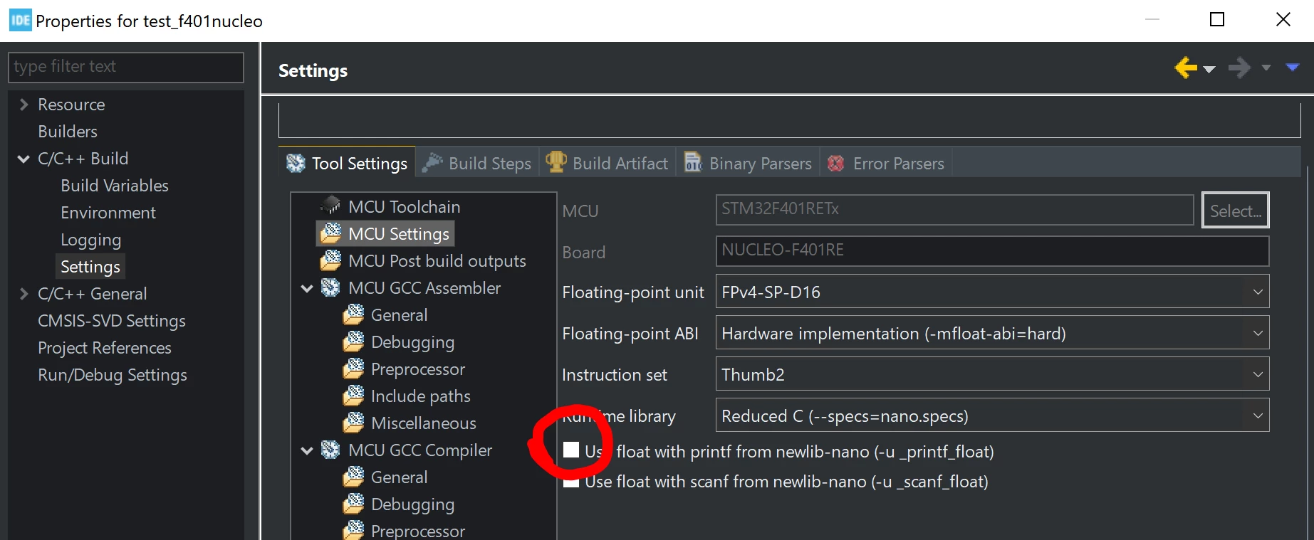

How to display the float value in Cube IDE .
 I am using Sprintf, but I cant see the number in UART
 LPS22HH_pressure=LPS22HH_GetPressure();
  sprintf(result,"%4.2f", LPS22HH_pressure); // @suppress("Float formatting support")
I have also tried %g
TDKBest answer
September 28, 2021
Enable float support for printf in project settings.
2 replies
TDKBest answer
September 28, 2021
