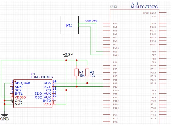

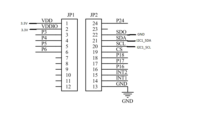

How to connect MKI197V1 to NUCLEO-F756ZGT via I2C but without an expansion board.
  • October 26, 2021
  • 3 replies
  • 3453 views
The problem is that the address of the device is unknown, I tried 0xD4, D5, D6, D7, A6 and many others, zero reaction.
To check, I use the function:
#define SENSOR_ADDRESS 0xD4
if (HAL_I2C_IsDeviceReady(&hi2c1, SENSOR_ADDRESS, 2, 10) == HAL_OK)
  HAL_GPIO_TogglePin(Green_led_GPIO_Port, Green_led_Pin);
Best answer by AGile.2
HI @Eleon BORLINI​ ,
It was possible to connect, my mistake was that I did not apply +3.3V to SDA and SCL.0693W00000GXUheQAH.pngThanks for the help:)

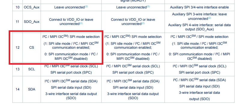

Hi, if you use the I2C you have to set at least the CS to GND (pin19). Suggestion is to follow also the recommendation of the datasheet.
https://www.st.com/resource/en/datasheet/lsm6dsox.pdf
AGile.2
AGile.2Author
October 27, 2021
Hi, thanks for the answer.
Most likely the opposite, CS to 10693W00000FDxanQAD.pngbut unfortunately there is still no response from the sensor.
Another question arose, should the interrupt be received on the INT2 port or not? maybe this is the problem

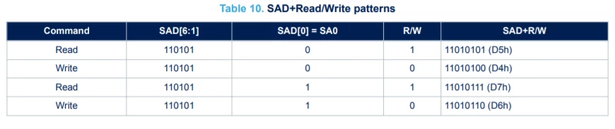

Hi @AGile.2​ ,
right, the CS has to be tied to Vdd in the I2C.
The INT lines are output lines, so they generate interrupts that have to be usually managed by the application processor.
You might try with a 7-bit address, for example 0x6A or 0x6B, from the table:
0693W00000GVnreQAD.png-Eleon
AGile.2
AGile.2Author
October 28, 2021
Hi, I've tried both with no success.
