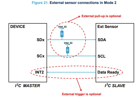

I have STEVAL-MKI197V1 (lsm6dsox sensor) that I use to communicate over spi with my stm32 board, and getting accelerometer and gyro data. Now I want to connect to the i2c lines of STEVAL-MKI197V1 a magnetometer(lsm303agr). How to setup this mode and read the raw data from the external sensor.

    Hi @suads​ , I suggest you to check the AN5272 p.65, where the sensor hub mode - Mode 2 of the LSM6DSOX is described, if not already done. Yo should connect PIN2 and PIN3 of the LSM6DSOX (STEVAL-MKI197V1) to the LSM303AGR PIN1 and PIN3, with the CS_MAG (I2C selection) high.
    On Github, you can also find an example code for the sensor hub between LSM6DSOX and LIS2MDL magnetometer --> lsm6dsox_sensor_hub_fifo_lis2mdl_simple.c
