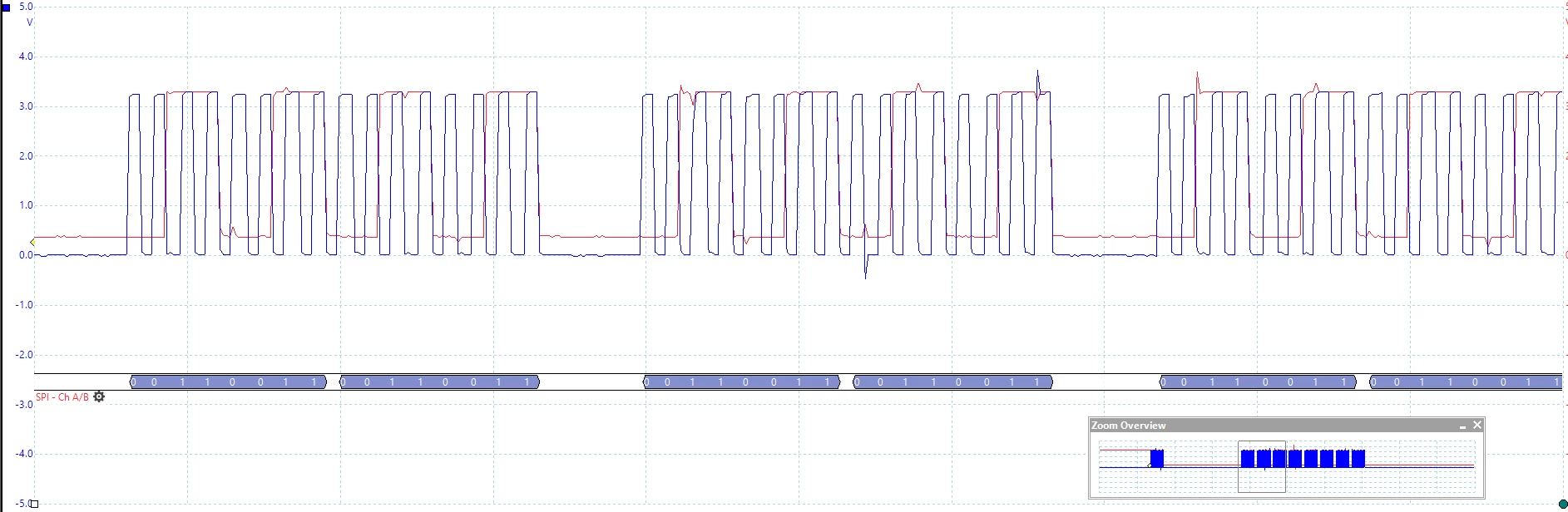

Hi! I am trying to establish a SPI comm with an LIS2DE12 accelerometer. First, I would like to say that I have checked phase, polarity, msbFirst and CS. I am using an EM9304 as the master of the communication, and the spi clock frequency is aproppriated.
Writing or reading from the sensor, makes it sends an weird symmetrical waveform in to MISO pin.
(This waveform is equal to the LIS2DE12 ID (0X33 = 00110011))
I had tried many different registers (writing and reading) and the sensor only send this signal.
PS: Both images corresponds to clock and MISO. The MOSI signals was checked too and it is sending the correct bytes to the sensor.

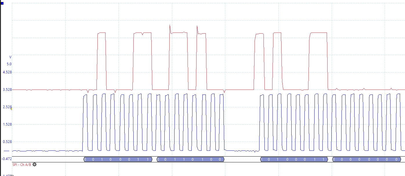

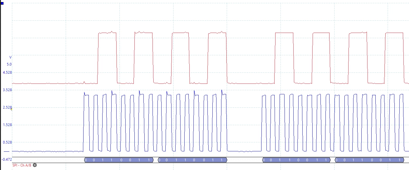

    Hi! Eleon, these are the prints from the oscilloscope with the MOSI and MISO signals. In the MOSI print, I am sending a write commando to CTRL_REG4 (0x23) and an 8bit data (0x34). In the following pack of bytes, I am trying to read te content of this same register (CTRL_REG4). As you can see, the module keeps sending 0x33 through MISO. 0690X000009k0J6QAI.png 0690X000009k0I8QAI.png

    ​I see.. the MOSI data seems ok and well synchronized... Is the Vdd of the sensor tied with the VddIO? What I could suggest you is to try decrease the Vdd value (which by now seems to be 3.3V)... But what does the second 16 clock pulses sequence of the last screenshot you posted refer to? Regards

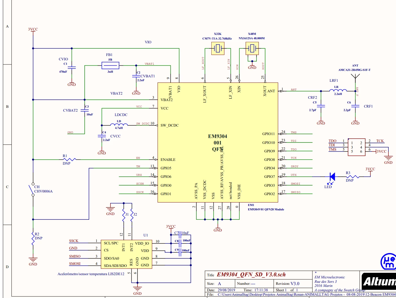

    Hi, Eleon! The second 16 clock pulses are an attempt to read the same register that I tried to write data in the first 16 clock pulses. The VDD of the LIS2DE12 is tied to VDDIO. Here is the schematic for more details. Thanks!0690X000009k8EnQAI.png

    The CS pin is connected to the ground. Is this an issue? My uC needs to control the CS pin to establish the communication?
    Eleon BORLINI
    October 8, 2019
    Thanks @luiscarmignotto​  for the sharing of the schematic. Yes, you need to be able to drive the CS, e.g. connecting it to the uC, because the SPI communication​ starts at the CS transition from Vdd(VddIO) to GND. Regards
