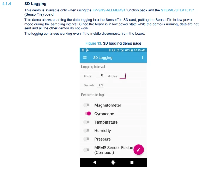

How to collect sensor fusion and IMU sensor data csv data concurrently on the ST BLE Sensor App with the Steval-STLKT01V1?
On the ST BLE Sensor App, I can only able to either export Accelerometer, Gyroscope, and Magnetometer csv files OR Sensor Fusion csv file. I was wondering if there is a way to export both of these files?
Another question, I was wondering if there is a way to get the linear acceleration from the SensorTile?
Thank you!

Hi @NLe.1​ , I believe you can do it by logging data on SD card and flagging all the sensors/features you are interested in. See also the ST BLE Sensor user manual UM2499, p.15.
