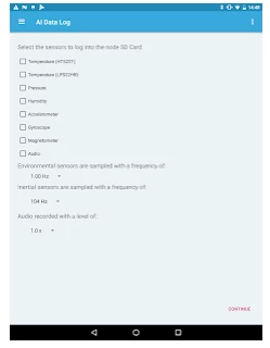

I have instaled the "ST BLE Sensor" on my smartphone and made some data collecting using accelerometer sensor. I have seen on the APP presentation that is possible to choose the frequency but I didn't find this option in the APP. I am seding a image of the APP section that show the option. If somemone could help to find this option, it will help me a lot on my researches.

    Hi, I double-checked with our Bluecoin experts and we think it is not possible to change the ODR / rate settings directly form the app. I suggest you a longer way, if you want to going on in using this evaluation kit for deeper tests: you could change the FP-SNS-ALLMEMS2 on your PC in the right part of the code with your desired rate (ODR), and then download the modified FW on the Bluecoin. Btw, which is your target application (it will determine the acquisition band of interest)? Regards

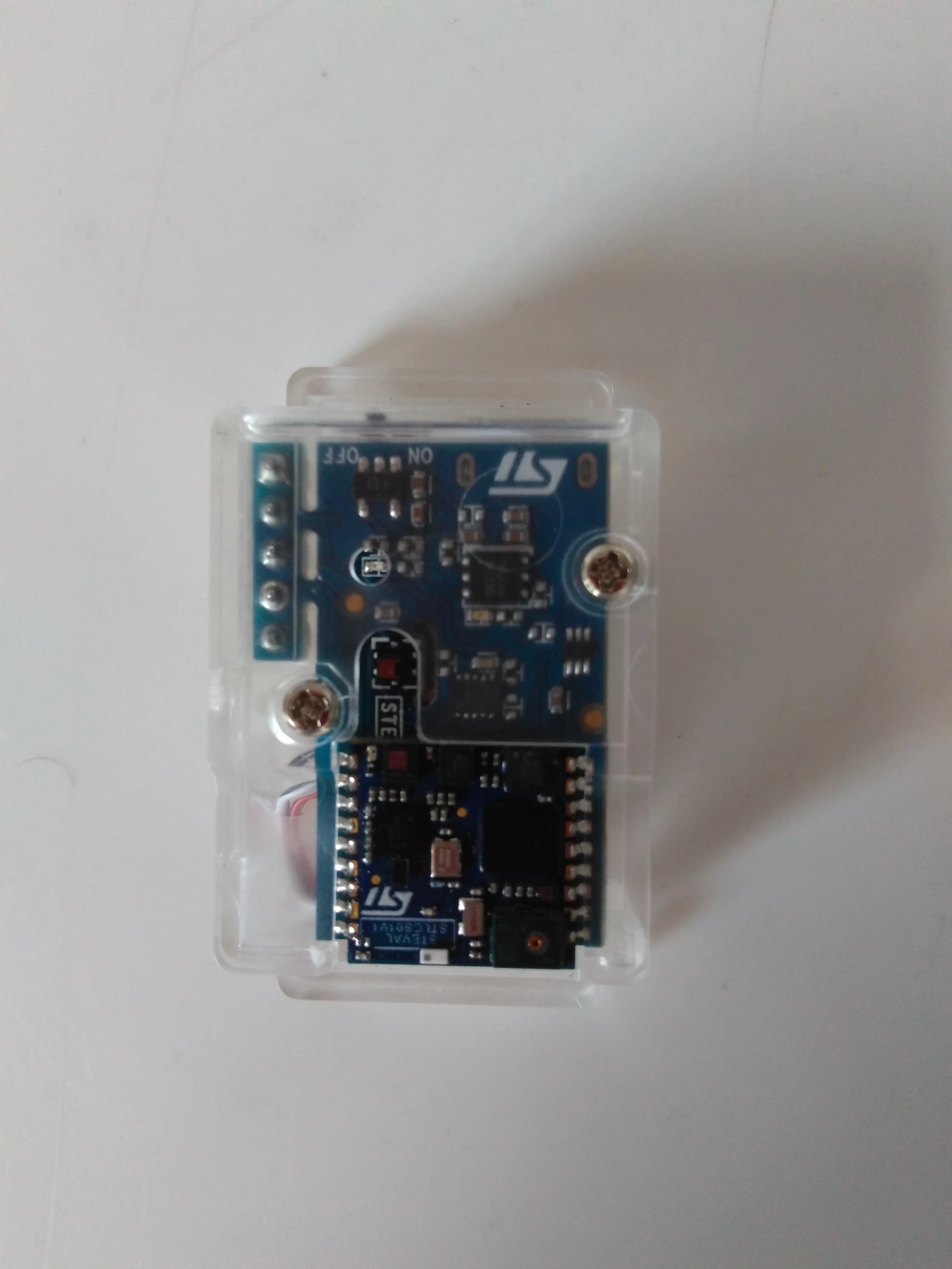

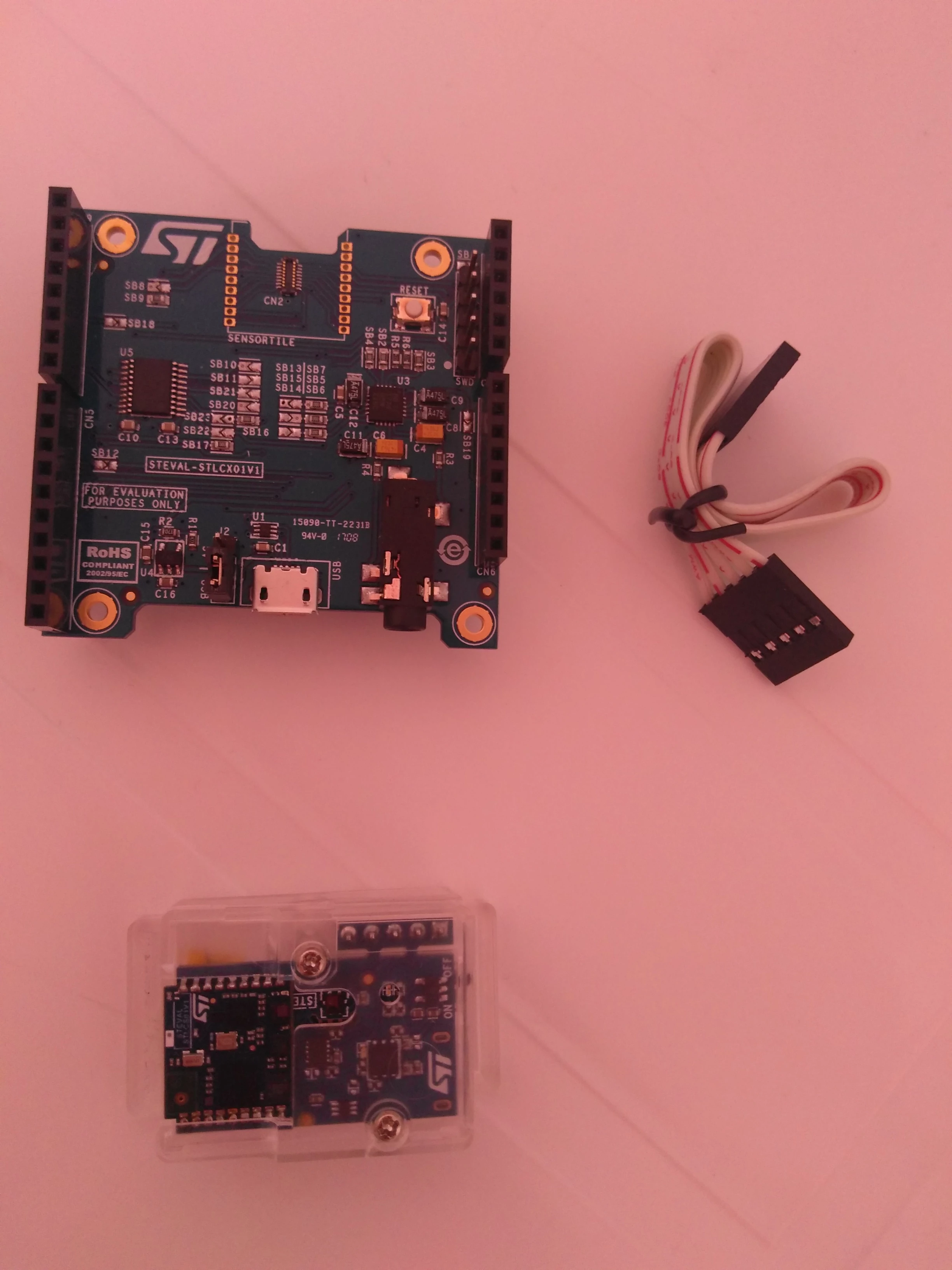

    Hi Eleon. Thank you for your support. I am a beginner in using this kind of technology. Thus, I have some questions and I will be very appreciated with your answers.
    First, I would like to know what is the sensor tile default frequency of acquisition?
    Can I do the process of changing the frequency with the device I have or it is necessary to have other hardware?
    Can you send me a step by step of how to do it?
    I would like to set the frequency of aqusition in 100 Mhz.
    Find attached the photo of my devices.
    Best Regards.
