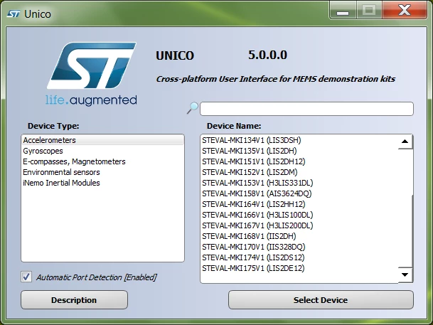

when i use STMicro motherboard STEVAL-MKI109V3 to evaluate the MEMS sensor board STEVAL-MKI136V1 and STEVAL-MKI179V1, found some problems.
1. I can not find the STEVAL-MKI179V1 in the device list of Unico.
    How to add new STEVAL board for other modules into Unico device list?

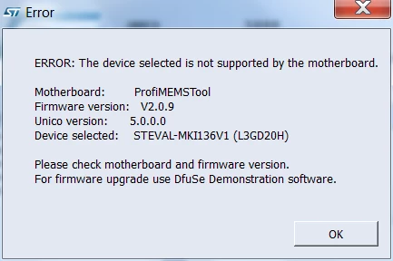

2. Use STEVAL-MKI109V3 to evaluate the STEVAL-MKI136V1, found error ''The device slected is not supported by the motherboard ''
    How to fix the fireware version error?

    We are aware of the missing support for STEVAL-MKI179V1 and we are working to upload the new version of the GUI/FW on st.com soon.
    Concerning the FW suppport for STEVAL-MKI136V1 I will ask the development team to add it (it should be already supported by motherboard STEVAL-MKI109V2 but not yet in V3).

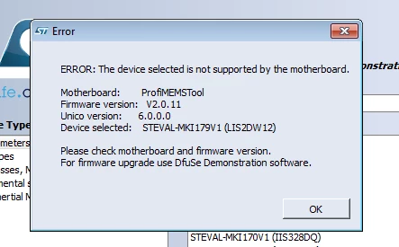

    Hi, I downloaded the Unico 6.0.0.0 and selected the STEVAL-MKI179V1 for
    LIS2DW12
    sensor. I am using the
    motherboard STEVAL-MKI109V3 and i getting the same error. How to solve firmware issue for this motherboard?

    Please update the firmware in your STEVAL-MKI109V2 boards.
    The latest FW is in DFU directory, together with the instructions how to do it, in
    /external-link.jspa?url=http%3A%2F%2Fwww.st.com%2Fcontent%2Fst_com%2Fen%2Fproducts%2Fembedded-software%2Fevaluation-tool-software%2Fstsw-mki109w.html
    package.
