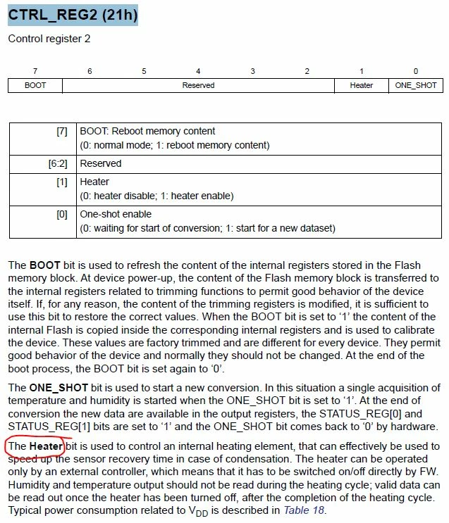

How long does it take to turn on the heater in MEMS HTS221?

    Probably the heater turns on immediate with the command, but thermal capacitance together with the heating power (100 mW @3.3V) will result in a slope. You can perhaps estimate with the data from the material datasheet.

    How long is it safe to turn it on? microseconds? milliseconds? seconds? Sorry for my google translator

    Monitoring the humidity and temperature should be possible while heater is on....
    No.
    The Heater bit is used to control an internal heating element, that can effectively be used to
    speed up the sensor recovery time in case of condensation.
    Humidity and temperature output should not be read during the heating cycle; valid data can
    be read out once the heater has been turned off, after the completion of the heating cycle. (c) Datasheet.
    Thought that ST would open the veil of secrecy.
    I will try to turn it on periodically until the humidity readings stop dropping.
