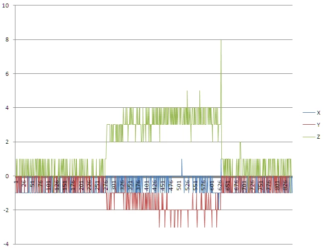

PArve.1
PArve.1Author
June 4, 2021
I did a simple dump to a serial port of the raw data from the registers (in signed unscaled format). ODR=400Hz but the serial port is only running at 2400bps, and each line is 12 chars, so one X,Y,Z triplet gets out approx. each 45ms. Rh=21%, T=21C.
The offset seem to be about -0.5 (raw), and the Z axis holds the earth gravity of 1g.
When I breathe on the sensor, I get a displacement of up to 4 raw (3.12g). Adjusting for the offset we'd see a peak of 3.5g (2.5g adjusting for earth gravity).
Its a bit odd that it is mostly Z that is affected. Note that the effect stays on for some time (the serial port reports samples quite slow).
This effect disappears if the data is AC filtered (CTRL2 = (0<<5) | (1<<4) | (1<<2) | 3). The earth gravity also disappears, and the raw data from all axes flicker between 0 and -1 mostly. But AC coupling also reduces peak height/width when the sensor see a "real" impact.
