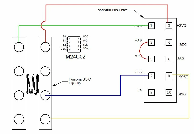

How do I write & save data to a 24c02 using a buspirate?
0693W000003PfS8QAK.jpgI have wired up the Bus Pirate in this manner.
When I try to write data this is what I see:
HiZ>m
1. HiZ
2. 1-WIRE
3. UART
4. I2C
5. SPI
6. 2WIRE
7. 3WIRE
8. LCD
9. DIO
x. exit(without change)
(1)>4
Set speed:
 1. ~5KHz
 2. ~50KHz
 3. ~100KHz
 4. ~400KHz
(1)>3
Ready
I2C>P
Pull-up resistors ON
Warning: no voltage on Vpullup pin
I2C>W
Power supplies ON
I2C>(1)
Searching I2C address space. Found devices at:
0xA0(0x50 W) 0xA1(0x50 R)
I2C>[0x50 r
I2C START BIT
WRITE: 0x50 NACK
READ: 0xFF
I2C>"This is a Test"
WRITE: "T ACK NACKh NACKi NACKs NACK NACKi NACKs NACK NACKa NACK NACKT NACKe NACKs NACKt NACK"
I2C>]
I2C STOP BIT
I2C>[0x50 r:20]
I2C START BIT
WRITE: 0x50 NACK
READ: 0xFF ACK 0xFF ACK 0xFF ACK 0xFF ACK 0xFF ACK 0xFF ACK 0xFF ACK 0xFF ACK 0xFF ACK 0xFF ACK 0xFF ACK 0xFF ACK 0xFF ACK 0xFF ACK 0xFF ACK 0xFF ACK 0xFF ACK 0xFF ACK 0xFF ACK 0xFF
NACK
I2C STOP BIT
So it appears the data I wanted write "This is a test" didn't get written.

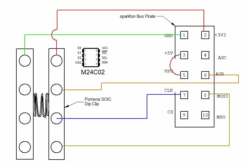

Next I hooked up the Auxiliary pin .
Then I tried to write data again:
I2C>W
Power supplies ON
I2C>v
Pinstates:
1.(BR) 2.(RD) 3.(OR) 4.(YW) 5.(GN) 6.(BL) 7.(PU) 8.(GR) 9.(WT) 0.(Blk)
GND 3.3V 5.0V ADC VPU AUX SCL SDA - -
P P P I I I I I I I
GND 3.31V 4.96V 0.00V 4.96V L H H H H
I2C>a
AUX LOW
I2C>(1)
I2C>[0xA0 r:20]
I2C START BIT
WRITE: 0xA0 ACK
NACK
I2C STOP BIT
I2C>[0xA0 "This is another test"]
I2C START BIT
WRITE: 0xA0 ACK
WRITE: "T ACKh ACKi ACKs ACK ACKi ACKs ACK ACKa ACKn ACKo ACKt ACKh ACKe ACKr ACK ACKt ACKe ACKs ACKt ACK"
I2C STOP BIT
I2C>[0xA0 r:20]
I2C START BIT
WRITE: 0xA0 ACK
NACK
I2C STOP BIT
I2C>A
AUX HIGH
I2C>[0xa0 r:20]
I2C START BIT
WRITE: 0xA0 ACK
NACK
I2C STOP BIT
I2C>[0xa0 "This is another test"]
I2C START BIT
WRITE: 0xA0 ACK
I2C STOP BIT
I2C>[0xa0 r:20]
I2C START BIT
WRITE: 0xA0 ACK
NACK
I2C STOP BIT
I2C>
So even with Aux High or Low I still seem to be unable to change the data in the eeprom.
Any Ideas would be appreciated.
