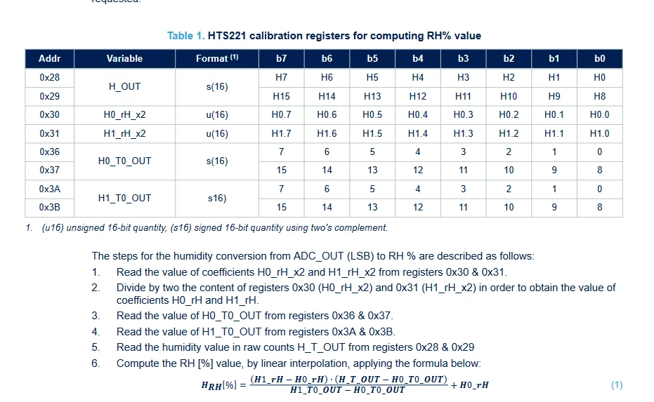

How do I verify if my hts221 sensor is giving the correct value and my calculations ?
 I am using the hts221 with i2c protocol for doing my calculation based on this reference:Application note for calculating relative humidity.
Observations:
  1. So I tried to read the respective registers and do the calculations as per the datasheet, with assigning s16(H_OUT,H0_TOUT,H1_TOUT) and u16(H0_rH_x2,H1_rH_x2) values and I got a negative value as relative humidity along with -ve values for H_OUT and H0_TOUT(Both of them were defined as s16 type).
  2. But when I switched everything to uint16, which is in contrast to the datasheet, I got a relative humidity of 36% which is ideal and real time value inside a home.
I am wondering why  this strange behavior occurs and is there something, I am doing wrong over here?
Al l am doing is reading the respective registers and assigning the values like this(eg: here H_OUT):
uint16_t h_out_res=((uint16_t)hum_reading[1]<<8)|(uint16_t)hum_reading[0];

Hello @Anare.1 ,
The HTS221 humidity sensor measures relative humidity and temperature and stores the values as two's complement integers (16-bit words) which can be read over the I2C.
I recommend you to refer to the :
* Figure 3. Reference code for HTS221_Get_Humidity API
** Figure 5. Reference code for HTS221_Get_Temperature API
Foued
niccolò
August 25, 2023
Hi @Anare.1 ,
the answer from Foued is right, check those figure out =)
Anyway, are you sure you are applying the formula correctly?
you can also refer to the drivers to get help =)
