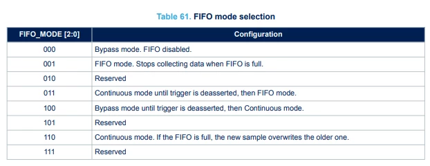

How do I switch between "Stream-to-FIFO" and "Stream" mode for LSM6DS3TR-C?
Hi, I need advise regarding my application. I can store historic data using Stream-to-FIFO mode based on single tap interrupt in buffer A. But, I cannot get data after the tap interrupt in buffer B when switching FIFO mode to Streaming mode. I believe I am not configuring the sensor properly to switch from one mode to another. My code is listed below. It collects and store historical data in buffer A and calculates threshold. If threshold is higher, then micro-controller is instructed to switch to the streaming mode and to store data in buffer B. This code returns watermark value 0 for the second part of the code (for buffer B part). It should be 1 for FIFO to output data.

    Hi @ASoni.2​ , back to this topic after long time... Your question is that, when you switch from"Stream-to-FIFO" to "Stream" mode, you cannot get no more data after the tap interrupt, right? Let's consider the device working conditions listed here below (AN5130 p.78):
    I believe you should esc the "Continuous to FIFO" mode, enter the Bypass mode (000b) and then switching to the Bypass-to-continuous mode (100b), which should be triggered by the interrupt and starting with the filling of buffer B.

    Hi @Eleon BORLINI​  Yes, I am fine with this query now. I have configured the sensor as stated in your answer.
