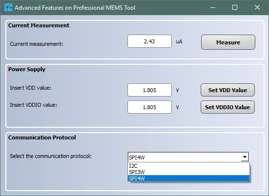

    Hi @Lmile.1​ ,
    I just got the answer from our experts and well... it's possible at GUI level!
    For many devices, IIS2DH included, in the "Option" tab you can find a button “Advanced Features for Profi�?, that allows (also) the communication protocol change.
    Please check the picture below for a guide:
    0693W000008wsmgQAA.png0693W000008wsmqQAA.pngIf my reply answered your question, please click on Select as Best at the bottom of this post. This will help other users with the same issue to find the answer faster.

    Hi @Lmile.1​ ,
    -Eleon

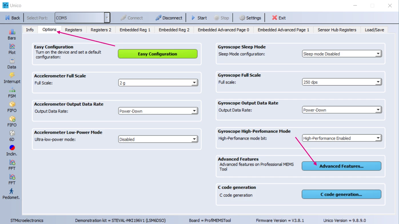

    Eleon BORLINI
    March 22, 2021
    Hi @Lmile.1​ ,
    you should be able to find it in Options --> Advanced features as shown in the picture below:
    -Eleon

    Hi Eleon,
    My demo kit doesn't seem to have the right side menu as yours does?
    My software version is the newer 9.9.0.0, how do I download your version. I am trying to
    use STEVAL-MKI168V1 (IIS2DS) yours is STEVAL-MKI196V1, a gyroscope? Maybe my accelerometer
    doesn't have that menu? Thank you for helping me! Larry
    Eleon BORLINI
    March 22, 2021
    Hi Larry,
    that's strange, I'll check better... But it could be related to the fact you are using a IIS2DH (I was checking with an LSM6DSO), and should check if this feature is device-dependent (I supposed it was not indeed...).

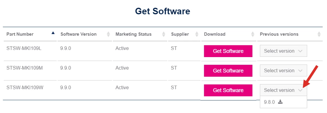

    You can however try downloading the previous version of Unico (for Windows, for example) from the st.com page:
    -Eleon
