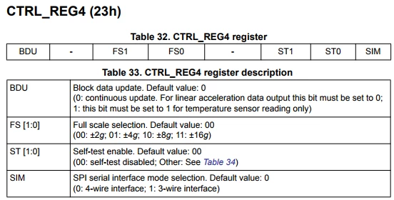

Posted on June 19, 2018 at 10:04
Uh I didn't get you. Where do I get the selected FS bits from?
Sorry I'm a complete newbie
June 19, 2018
Posted on June 19, 2018 at 10:13
In CTRL_REG4 register.
