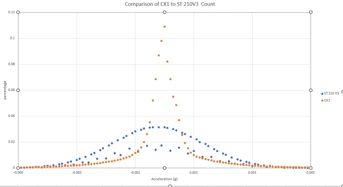

    0693W00000SuRzAQAV.pngOne of the reasons for using the ST accelerometer is as a replacement for an industry standard EOL accelerometer, the CX1. This is the results from measuring thermal load using the 210 and the CX1.
    This is not the same beam, that will take me a while. But the 210 has an interesting signal.

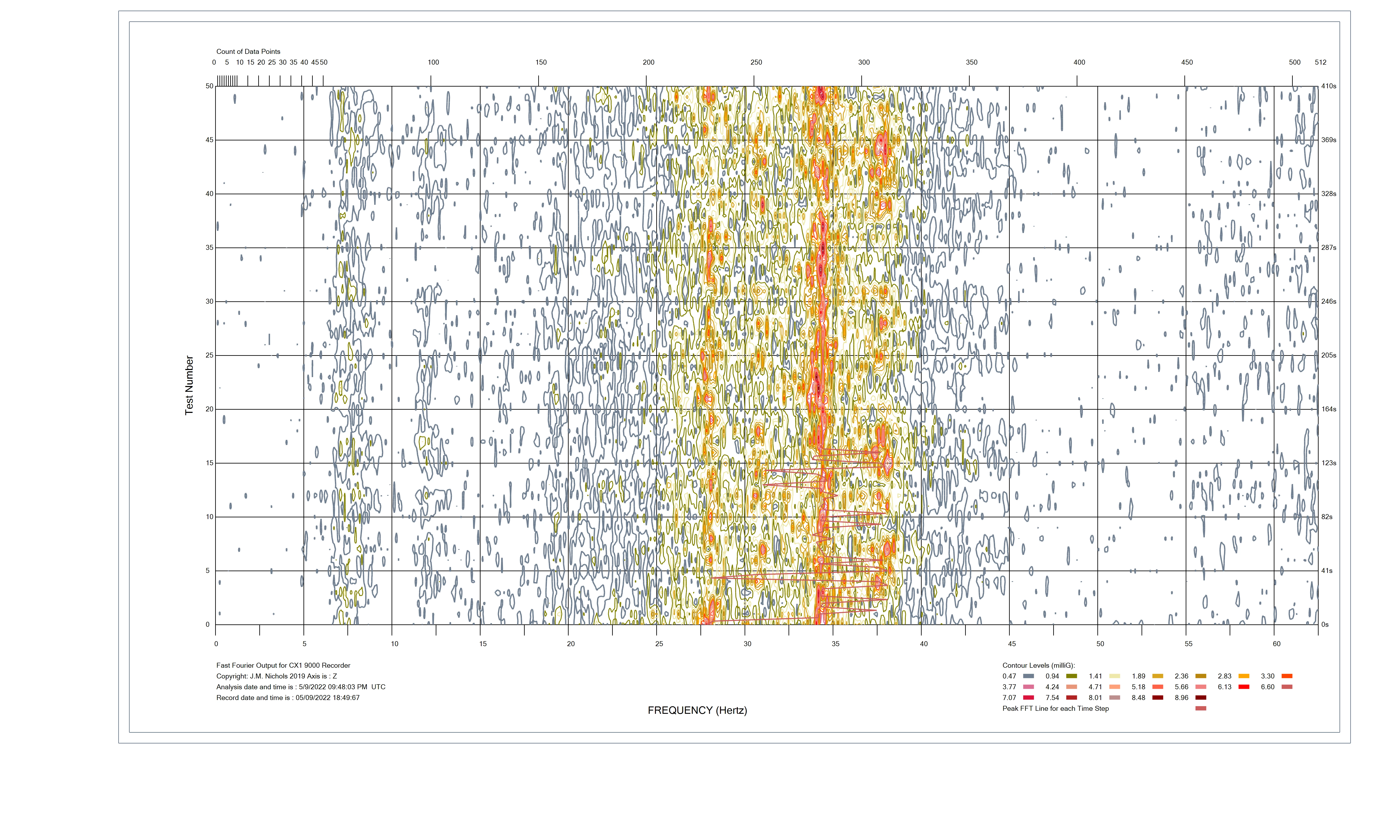

    Some nice pictures coming from the 210 coupled with the 109. 0693W00000SucqTQAR.pngThis is 51 FFT sets of 16384 points contoured using the CONREC package from Western Australia rewritten in C#. It is a 200 yr old wooden boat.

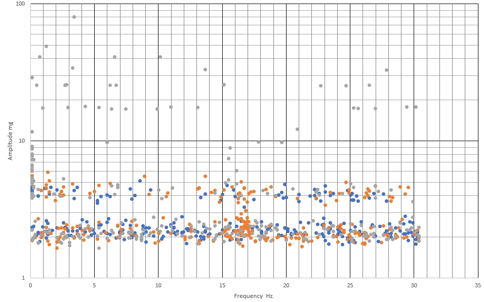

    0693W00000SucrCQAR.pngThis is the FFT data, along with the selection of the critical peaks that are then color coded for use.
