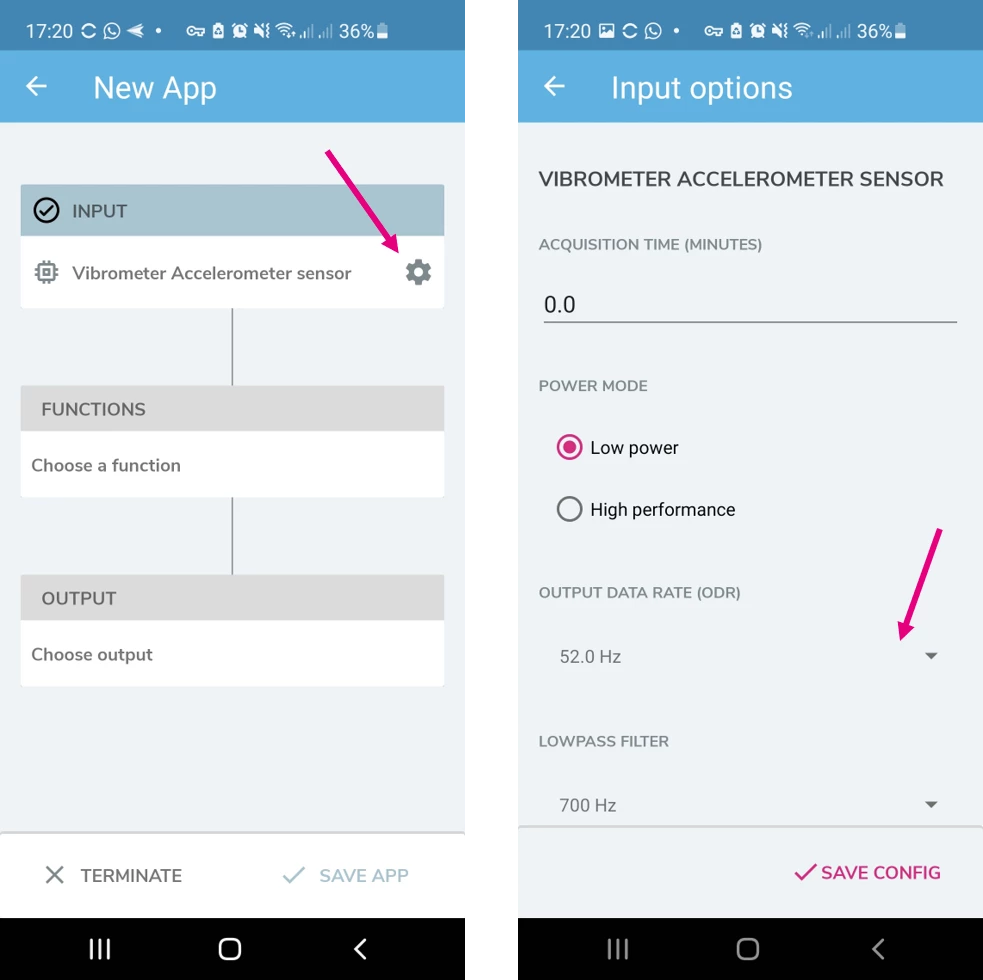

Hi @Nicolás Martinez​ ,
The easiest way to configure of the SensorTile.Box sensors is to use the STBLE Sensor app, selecting a sensor and configuring its ODR as shown in the picture.
If however you are using the source code of the BLEsensors app you can change the ODR parameter from the file SensorTile.box_motion_sensors.c that you can find in the \Drivers\BSP\SensorTile.box folder, and particularly the function:

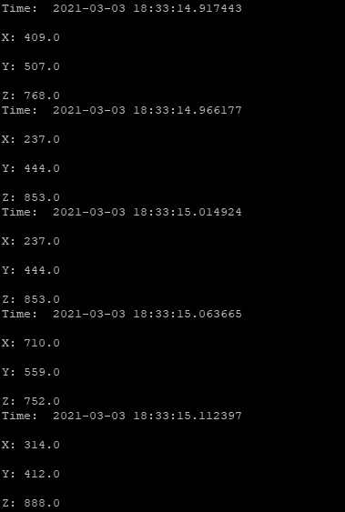

I tried to used that function changing the odr value several times, with different values, but when I read data, I got it every 0.05 seconds. Is there another parameter apart from odr? Maybe the sensors sampling frequency is being modify but not the frecuency data is updated.
I'm using a RPi 4 for the BLE connection. I modified the example_ble_1.py script from the STBlue sdk to read x,y ,z and timestamp. The output is the next:
Thanks

I found the parameter for changing the rate of the update of accelerometer value. On TargetFeatures.h, there are for parameters for enviromental features, inertial features, for blinking the led and for VCOM (i don't kown what is that). If you change the parameter STBOX1_UPDATE_INV, you change the frequency in which acc,gyro and magnometer features update its value.
Thanks anyway
