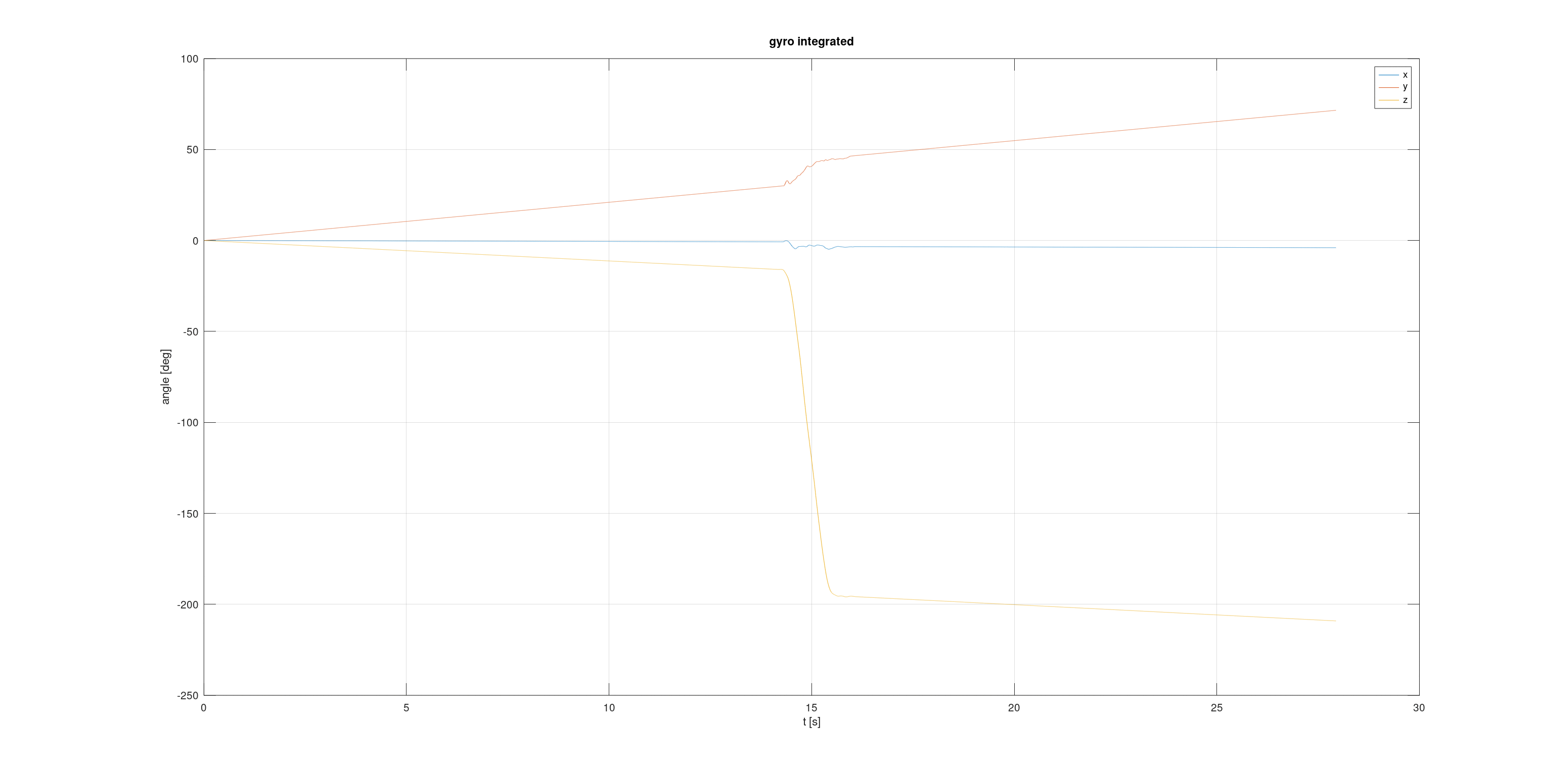

I'm going on with the testing, and there is still something that I don't understand.
To validate the setup, I rotate the device a by 360° round the z axis, while integrating the gyro. The integration is the accumulation of the gyroscope raw samples multiplied by the sampling interval. The integrated gyro should show a rotation of 360° and of course I expect also to see some drift because of the offset.
I'm using 200Hz sampling (sensor set to 208Hz), 500dps full scale and 0.0175 as sensitivity.
The result is shown in the image:
0693W00000BcY6NQAV.gifLooking at the yellow trace (which is the integrated Z axis of the gyro) it is clear that the measured rotation angle is closer to 180° rather than 360°. So it seems that the gyro is using a different FS setting.
I'm using this funtion to set the FS
LSM6DSO32_GYRO_Driver.SetFullScale(&lsm6dso32_obj_0,500)
Am I missing something else?
Eleon BORLINI
Jul 2, 2021 3:07 PM UTC
Hi @Davide G_Oiovanelli​ ,
The FS setting is common for all the axis, so I don't thins this is the issue...
A general suggestion when using an algorithm that integrates the sensor outputs is to periodically run a calibration of the device, to minimize the error coming from the integration.
I'm not sure that the 180 deg jump is coming from an "overflow" of the sensor Full Scale... does you code take into account the sign of the rotation correctly?
-Eleon
DGiov.1
DGiov.1Author
Jul 2, 2021 3:32 PM UTC
the problem here is not an overflow, I feel to exclude it since the device is set to 500deg/s and I was rotating the device with the hand (the full rotation takes 2-3s, it cannot be more than 500deg/s).
The problem is that when I rotate the device for 360deg, the accumulation/integration of gyroscope data returns aproximately 180deg (what you see in the yellow trace of the image in previous post) and not the expected 360deg.
In this test, the fullscale is set to 500deg/s using the provided drivers and the sensitivity is therefore 0.0175deg/slsb
Eleon BORLINI
Jul 5, 2021 12:34 PM UTC
Hi Davide,
ok it's clear, it looks a scale issue, effective.
But is the value on the other axis the correct one? And are you integrating with the correct time-base?
And what if you change the gyro FS, for example to 1000dps?
For completeness, let me past here below the LSB to mdps conversion formula (where the int16 cast acts as two's complement conversion):
float_t lsm6dso_from_fs500_to_mdps(int16_t lsb)
 return ((float_t)lsb) * 17.50f;
-Eleon
DGiov.1
DGiov.1AuthorBest answer
Jul 9, 2021 3:20 PM UTC
Hi Eleon,
there was a problem in the data preprocessing in matlab and I was discarding half of the samples, therefore the sampling interval was doubled, that's why I had to multiply by two the sensitivity to get consistent results.
Now the gyroscope works as expected.
Thank you again,
Davide.
