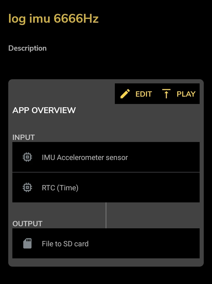

To attempt to accomplish this I used the "ST BLE Sensor" app from the Google Play Store. I entered expert mode and configured the following inputs:
  • IMU Accelerometer sensor (6666Hz)
  • IMU Gyroscope sensor (6666Hz)
  • RTC (Time)
I configured the app to output to the SD card.

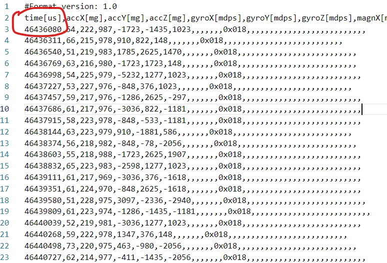

  1. I calculated the data rate of the sensors by dividing the number of samples in the log file by the time it took to capture the data. The calculated data rate was ~1600Hz! Much less than the 6666Hz I configured. Why am I not able to log data to the SD card at 6666Hz?0693W00000NqEBxQAN.png
  2. The timestamps in the csv log file were in "hh:mm:ss.ms" format. For example: "12:18:27.854". Is it possible to capture microsecond and nanosecond data from the sensors? At higher data rates many timestamps are the same since the data is being logged at a higher rate than the time log can change. I want to be able to know exactly when the sensor output was made.

    the difference between expected data rate and the one that is saved on sdcard is high, but keep in mind that the default fw for sensortile.box is not as accurate as a custom firmware made for logging.
    mainly because it is built with so much feature embedded, that a precise log at 6kHz is not its target.
    there is also a problem with FreeRTOS, on which the firmware is built: the smallest timing set at 1 ms, so it is hard to work on timings lower than that (ODRs > 1kHz).
    while the accelerometer and gyroscope data is buffered to be written at a higher speed, I don't think that the RTC data is buffered too.
    so, on this topic, it is not possible to see the EXACT timing of the data.
    your best option, is to develop a custom firmware to log the data.
    starting from STM32CubeFunctionPack_STBOX1_V1.3.0, as you did, is the right way to go, in my opinion.
    remember that you can check the difference in percentage of the effective ODR (and Timestamp Rate) with respect to the typical by checking register INTERNAL_FREQ_FINE (63h).
    in the DataLogExtended project, the timestamp should be the one from the board, so the microseconds are right.
    there can be a problem in both ODR accuracy and usb optimization in the code, you can check that with the register I mentioned above.
