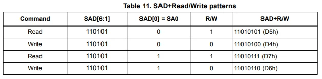

Hello ST Community Experts,
I am completely beginner here. We have purchased STEVAL-MKI207V1 for Accelerometer, Ti MSP432 as MCU. We wanted to connect both over I2C. But facing some problems.
STEVAL-MKI207V1 Kit has ISM330DHCX sensor. I checked datasheets for Adapter board and for Sensor. But little confused regarding I2C Connection.
  1. Could not find I2C Address easily for ISM330DHCX in its datasheet. (assumed WHO_AM_I register's value - 6Bh, we could be totally wrong regarding this assumption but scanned via I2C Scanner and found its address as 0x6b so assumed after checking in datasheet). So how we can find any I2C address in datasheet?
  2. How we can connect both modules over I2C and program it to get 3-axis data to MSP432. (What registers should be set to achieve data acquisition over I2C connection.)
  3. Was this a good idea to purchase this adapter board STEVAL-MKI207V1 for collaboration with Ti's MSP432 LaunchPad? (As we are experimenting)
Please anyone can help with this problem. Or at least guide us something about where we were wrong or how we can start?

Hi @HarshC​ ,
1.As you can see from the table below (you can find it at p.38 of ISM330DHCX datasheet), the SAD is composed by 3 parts, and the proper I2C slave address is the SAD+SA0. So the two possible I2C address values are 6Ah and 6Bh. SA0 value is determined by the PIN 1 hardware status (if SA0 at GND, the value is 0, while if SA0 at Vdd, the logical value is 1). So in your case the SA0 pad should be at Vdd.
2. You can base your code on the standard C drivers on github repository, both for standard drivers and examples, at this link. Btw, consider that for STM32 MCU family there are plenty of dedicated FW examples and libraries (FP-SNS-ALLMEMS1, FP-AI-SENSING1, etc), especially if you are oriented to the IoT world and potentially to the AI environment. For I think you should ask to TI community on how to program MSP432...
3. See point number 2 ;)
Regards
