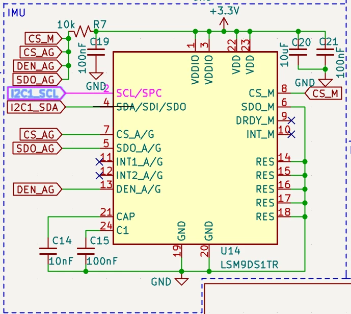

hi, im using LSM9DS1 in my new board. i can get the address when i use i2c scanner code, but when i try to read from it, there is no data coming in either from gyro/accelero or magnetometer.
  • August 24, 2022
  • 0 replies
  • 757 views
0693W00000QOOJ9QAP.pnghere is my circuit for the LSM9DS1
i used the code from sparkfun breakout moduel to test the board. i can get the data from their board, but not my board.
