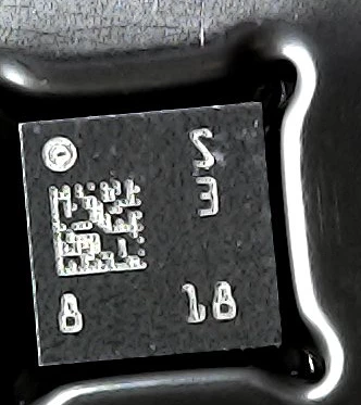

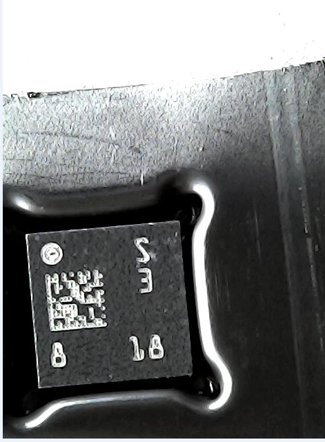

Hi, i have LSM6DS33TR, marking 2dbarcode, рow can I read the label and make sure it is LSM6DS33TR?

Hi @PGrad.1​ ,
It looks effectively a LSM6DS33TR, that is characterized by the "SE" marking and the year / week marking indication.
0693W00000Dm7hoQAB.pngI cannot disclose the details of the 2D matrix code (you can contact a sales and representative office from the contact page), but the numbers below stands for the "year" (1 number) and "week" (2 numbers). For example, in the attached picture the "7" refers to the year 2017 and the "23" to the year's week of the assembly.

Thank you Eleon BORLINI, as I understand the marking "SE" - means LSM6DS33?
This information can be indicated somewhere?
