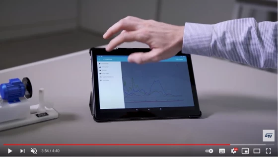

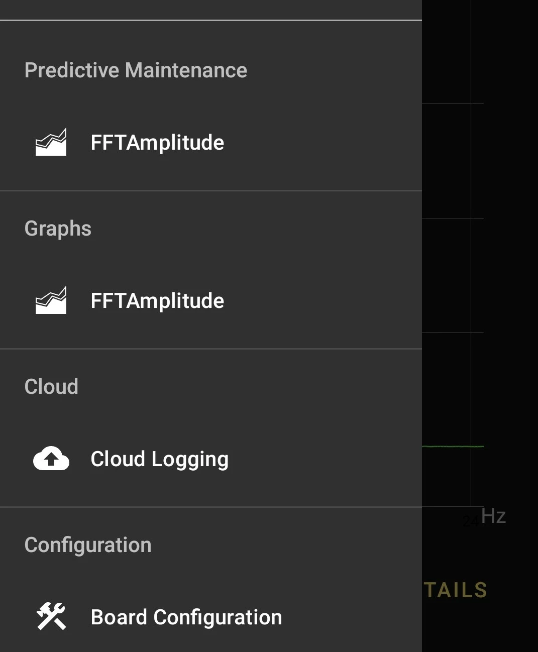

Hi, in this video (https://www.youtube.com/watch?v=J3M0_9EdOqU) they use the FFT amplitude window by clicking on the top left of the page and selecting FFT Amplitude from the menu.
0693W00000CzyWvQAJ.png0693W00000CzyfEQAR.pngIs this what you are looking for?
Tom

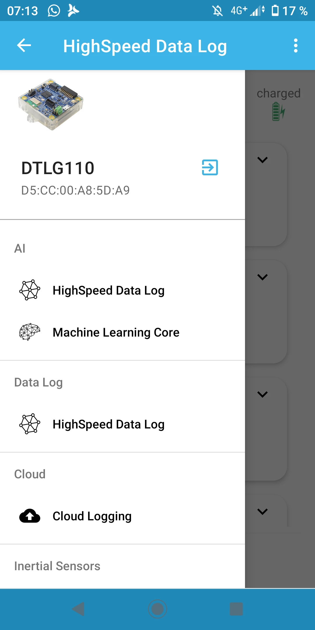

Hi, this is exactly the video i was talking about. I made a screenshot, to show you my screen. I just can't find this option.

uhm the app is changed meanwhile.
Try with the example bin in the FP-IND-PREDMNT1 (https://www.st.com/en/embedded-software/fp-ind-predmnt1.html), it is the default firmware and should activate the FFT .
